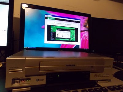

Introduction: Turn an Old VCR in a Desktop PC
Preface: my wife needed a new desktop PC, and I had a powerful Mini-ITX ASUS fanless motherboard lying around, bought some time ago for research purposes (I'm a software and embedded systems specialist).
So... i could have just put the motherboard in a standard micro PC case, but, where is the fun?
Just the time to go in my basement, and voilà! An old small VCR I kept for component salvage, that has the right size for the new contents ;)

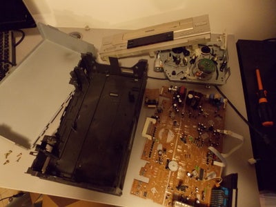

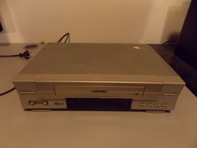

Step 1: Find the Right "case"
I've found this old small Toshiba VCR in my basement, that perfectly fits my needed dimensions.
The firts step consists in removing all unneeded parts from the inside.

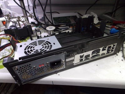

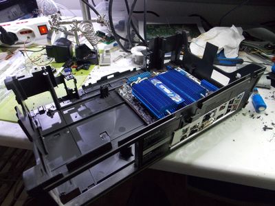

Step 2: Motherboard Installation
The motherboard installation is very simple: I've just glued four small pieces of forex plastic (that rigid plastic made of PVC, usually used for signs) I had in my "scrap box", and screwed the motherboard on them.
You can even use some small pieces of wood, also.
The "rear window" for the motherboard was made simply cutting a rectangular area of plastic with a cheap rotary tool.
Step 3: Power Supply Installation
The VCR box had an aperture that almost fitted the size of the Flex-ATX power supply. I just needed to enlarge it a bit with the rotary tool. The power supply is fixed in place with just a bit of hot glue.

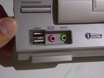

The original VCR had audio and video RCA connectors on the front panel. Just the right place for extra USB and audio connectors!
I've salvaged a connector board from an old pc case, trimmed it a bit, and hot glued on the front panel of the VCR (with just a little bit of trimming to give space to the usb connectors, since the original receptacle was recessed).

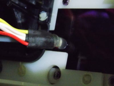

I've also glued two LEDs for power and hard drive access status in the back of the transparent window where was the VCR display. Note: in the photo you can see a bicolor LED (the type of LED with 3 pins). You cannot use this type of LED, because it has common ground. The motherboard needs to have a separate grounds for LEDs, because it switches power on the cathodes of connected LEDs (+5V lines are always connected).
After tested the issue, I've replaced it with two normal LEDs.

Connect all the needed wires inside (motherboard power, hard drive power, sata cable, fan cable...), install a SERIOUS operating system on it ( http://manjaro.org/), and enjoy!
Thank you for watching!
