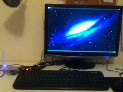

Introduction: Turn Your Raspberry Pi Into a Desktop PC
How to turn a credit card sized, $35 computer into a fully functional Desktop PC with surprising good performance.

Step 4: Finished!
15. customise the desktop to your liking (Not covered in this tutorial).
16. Done! You now have a fully functional and relatively fast desktop computer running on a Raspberry Pi with essential programs installed!
