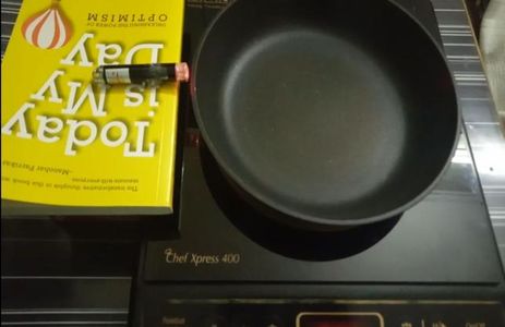

Step 1: Setting Up the Experiment
  1. Wrap a small piece of tape around the laser pointer so that it pushes down its On button and the laser point remains in a working position.
  2. Place the pan over the induction cooktop. Now, stack some books beside the cooktop and rest the laser pointer on the books. Make sure that the laser’s beam passes no more than 1-2 centimeters over the induction pan's surface.
  3. Tape the printed image of the human eyes to the wall with the leaser pointing directly at the center of one of the eyes.
  4. Turn On the induction cooktop and observe the laser beam on the printout.
Step 2: The Twinkling(appeared) of Star
We observe that at first the laser spot on the eye is steady. There is no flickering/wobbling of the laser spot. But as the pan gets hot, we will notice the laser spot starts to wobble and flicker.
