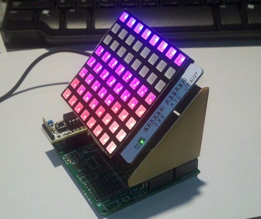

Have you ever finished a project and then realized you stopped one step too soon?
While plugging in various shields I have into the ‘Wing Tip Extensions’ I built I noticed an odd thing…display shields needed to be rotated 90 degrees to be of any real use…case in point the Adafruit RGB Display Shield shown, it works just fine but it’s orientation doesn’t work.
Back to the drawing board…or this case Eagle Cad.

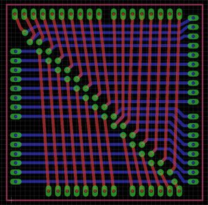

Step 2: The Design...
The design is straight forward and is configured for a UNO R3 layout.
I couldn’t figure a way to do it with only one side so I made it into a double sided layout.
The via’s are larger than normal to accommodate drilling the holes.
No room for any icons…just a simple layout.

Step 7: Assembly
For this example I installed the Wing Tips and then added the Twist Shield on top
Installed the Adafruit RGB Display Shield and Voila!
It works! The display and buttons are correctly aligned now.
