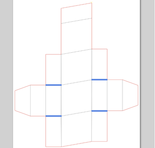

I started off by trying to sketch and visualize how the form would look if it were unpackaged and laid flat. Since I was already familiar with the design and iteration process, I decided to start off by manually drawing and cutting my own block to get the idea of how the folds and tabs would work in tandem and come together. There was a lot to decide in the design--how twisted should the cube be? Are the twisted sides still equal in length with the sides that are not?
Since this design was inspired by one of the forms in Paul Jackson's magazine, "Structural Packaging: Design Your Own Boxes and 3D Forms," I was already provided with the information that the twisted angle should not be greater than 10 degrees, or the form might fail. Thus, the angle at which the box is rotated at was set to ten degrees. Additionally, I could not decide whether the twisted side should equal the normal side. Coming to the conclusion that twisting a box will not change its dimensions, I set all sides equal to each other.
With this first iteration, I could confirm that the lines and measurements I drew is a step closer to my desired result. Additionally, this trial run allowed me to grasp some of the flaws within my first design, especially with the tabs. The tabs being exactly a half of the side of the cube worked well, but the diagonal, final tab could not fully close. Thus, I made the change to make the tabs in a trapezoidal shape--the test object and changes can be seen in the pictures below.

Step 2: Initial Prototype
After the 2D net was completed on Fusion 360, it was time to laser cut the form out. This iteration did not come out perfect, so a lot of improvements were to be made. As seen in the image, the prototype's edges were frayed; it is evident that the default settings were not strong enough to cleanly cut through the card stock. Additionally, part of the form that was supposed to be cut (highlighted in blue) were not cut, so I had to rip them manually to make the cube close. Lastly, as there were no setting for scoring on card stock, the prototype had no engravings.
With a little experimentation with the power settings on the laser cutter, I found that the best setting for cutting through the card stock was at 15% power and 90% speed. As for the engraving setting, 5% power and 90% speed worked great.
Step 3: Final Design
With the final iteration, I am very pleased with its outcome. Its cuts are extremely clean and satisfying to see; I am glad that the box did not turn out too small. In future iterations, I do want to consider the paper size when designing the 2D net so I could optimize the amount of paper used and thus make the box bigger. I did not see any snapping tool or working camera for the laser cutter to measure the file to the paper, so I made it slightly smaller so the laser would not miss. Overall, I am very content with the final product.
