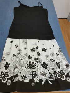

In this instructable I am going to show you how to take a nice tshirt and a nice tank top which together cost just over $5.00 CDN and put them together and have a dress that would sell in Canada for about $45.00. In this instructable you will also learn how to pleat. Skirts are very often gathered when they are full but sometimes it looks nicer or suits a person's build better if the fullness is pleated. Both of these items are new but together they provided me with a very nice dress and it was a lot of fun putting it together.

Take the patterned tshirt portion and measure its width. Do the same with the bottom hem of the tank top.
In this case the tank top is 28" across the bottom hem and the top edge of the patterned tshirt is 42". Attaching the 2 pieces will present a problem as one is appreciably wider than the other. Not to worry. This gives us an opportunity to incorporate a neat design feature.
Put the width amount of the smaller over the width amount of the larger and you will end up with a fraction 28/42. This reduces to 2/3. So we need to reduce the width of the wider one by 1/3.

In the first picture the pin is showing the mark that the top mark should overlay.
The second picture shows the 2 marks on top of each other and the fabric bent back on itself.
The third picture shows that now the 2 widths are the same and it also shows the right side results of the fabric folding that was done on the back.
The fourth picture shows the 2 pieces attached. Notice the flat appearance in the centre.
With all of the pleats pressed flat, run a line of stitching a 1/2" down from the top edge and another line of stitching 1/2" below that. Placing the tank top finished hem on top of the top edge of the fabric, stitch in the ditch with matching thread. You can if you want, make the stitching in the same fabric as the lower skirt for a design feature. In that case you might want to run 2 or 3 line of stitching.
