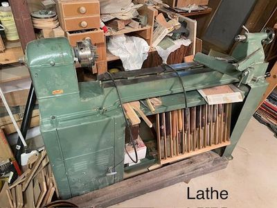

We necked down the dowel for the handle from 2” to 1 ½” on each end on the lathe to fit the holes in the end pieces.

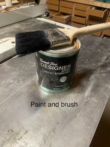

Paint over the name with acrylic black paint and let it dry (you may have to do this multiple times).
