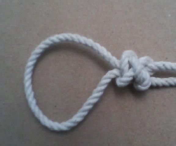

Step 1: Two Strand Lanyard Knot
Make a small loop and tie overhand knot.

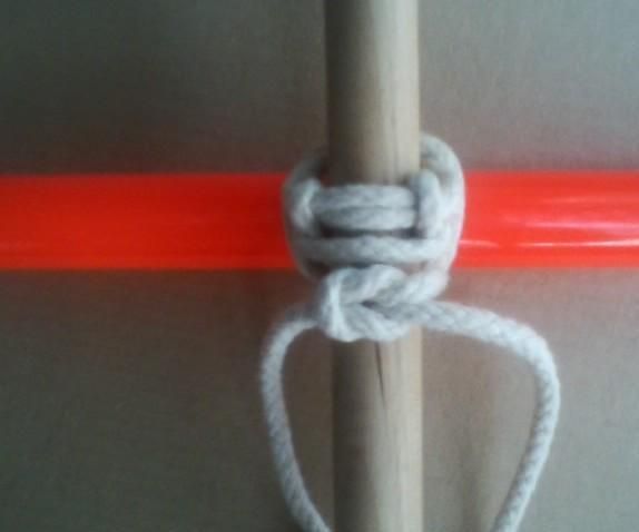

Step 2:
Bring the left hand strand across on top of the loop, then bring right hand end across underneath.

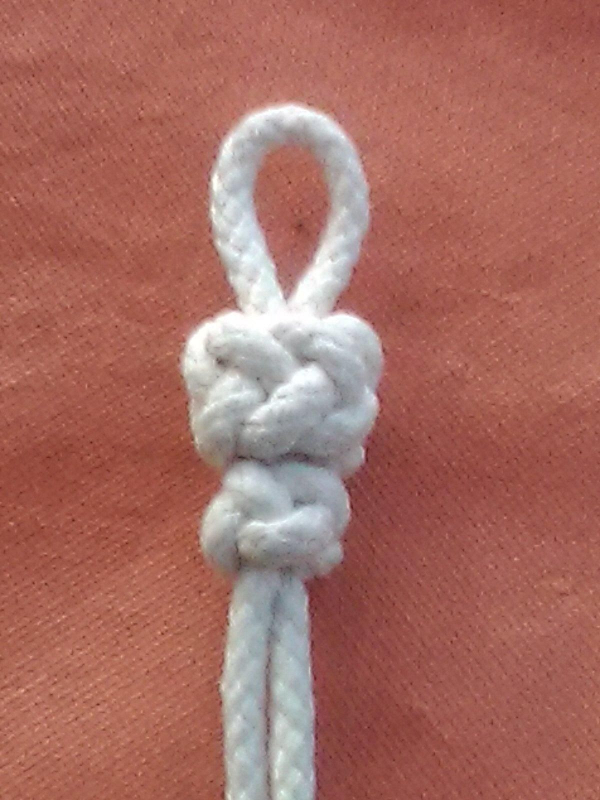

Step 3:
Bring left hand end across on top and down through bight as shown, bring right hand end underneath and up through bight.
Step 4:
You can stop now and create the shortest knot. Bring the left hand end down through the left hand bight of the first overhand knot. Bring the right hand end up through the other bight. Tighten
