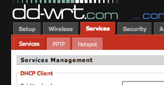

Step 3: Setup
- Go to 192.168.1.1 in your browser
- click the 'services' tab, enter your password if neccesary
- scroll down to DNSMasq, and make sure it is enabled
- Under 'Additional DNSMasq Options' enter: address=/www.your_site.com/ip_address
ex (redirects www.youtube.com to instructables): address=/www.youtube.com/72.249.66.26
- scroll down and click apply. thats it!
