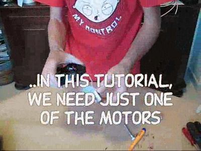

Step 1: Dismantle the Drive
Dismantle the (broken) cd/dvd player. You'll find a lot of interesting parts (e.g. the lens), but in this tutorial we need just one of the motors (usually are 2, and the damage is somewhere else, so they works). Take it out.
NOTE: every drive is different "inside", so it's a bit useless show you where is located. But you can see the picture to know what you are looking for.

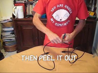

Step 4: Prepare the Usb Cable
Take the usb cable and cut it to the desired lenght, then peel it out leaving only the RED and the BLACK wires (isolate the other 2).

Step 6: Fix the Motor
Fix the motor to the cable and solder the usb wires. Isolate all with tape.
