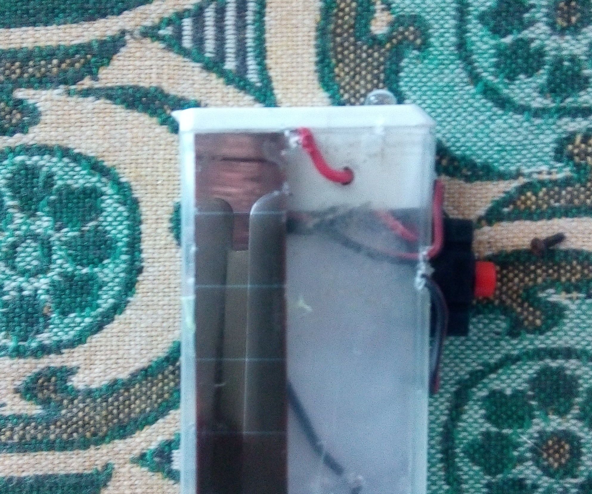

Then take the case and make holes in it to attach momentary switches. I attached 8 switches in the front and 2 at the top. I made the holes using a soldering iron
Step 7: CONNECTING THE WIRE FROM THE PCB TO THE SWITCH
After preparing the case connect the wires from the P.C.B to the momentary switches which are attached to the case.
