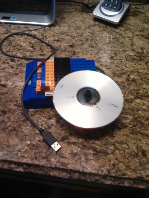

Step 4: The CD
Now, Set the mouse and box aside for a moment and grab your CD disk. We are going to place the smooth blocks on the Spinning Thingy like in the picture. And then Hot Glue the smooth blocks and Spinning Thingy to the center of the CD. Be careful not to get any glue on the Spinning Thingy or our DJ Scratcher wont work very well.
Let that Dry and make sure it spins.

Step 7: Placing the CD
Alright, We are almost there. We need to line up the CD on the side of our Box with the mouse wheel. Depending on your mouse you may need to add a few thin plates on the edges. It's a little bit of Trial and Error. Your CD should lay on the Mouse Wheel and stay level. It's important that you place it carefully and take your time on this step.
You may also want to add a little CD support to keep the CD from falling off of the box.
Step 8: All Finished!!
Add any decorations or additions you desire. You should be able to plug in your USB mouse into your computer.
