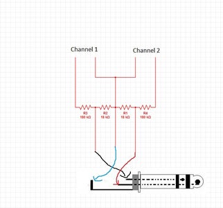

With the Resistors we want to make two ten to one voltage divider (one for each channel)
Then we will Connect the Divided side to one of the jacks, and the other side will be the booth channels of our Oscilloscope.

Step 3: Signal Generator
For the signal generator, we will just use the seccond Jack.
Connect the GND of the Jack with two of the Banana Jacks, i prefer black for it.
Now connect one of the other two pins to the first red banana jack and the other pin to the other red banana jack.

there is nothing mutch to say, just install the sockets in the box solder them to the resistors and to the Jacks.
I put the jacks with cable ties together, so they fit to the Soundcard.
Then plug it into the soundcard, signal generator plug to soundcard output and Oscilloscope to LineIn /Mikrophone

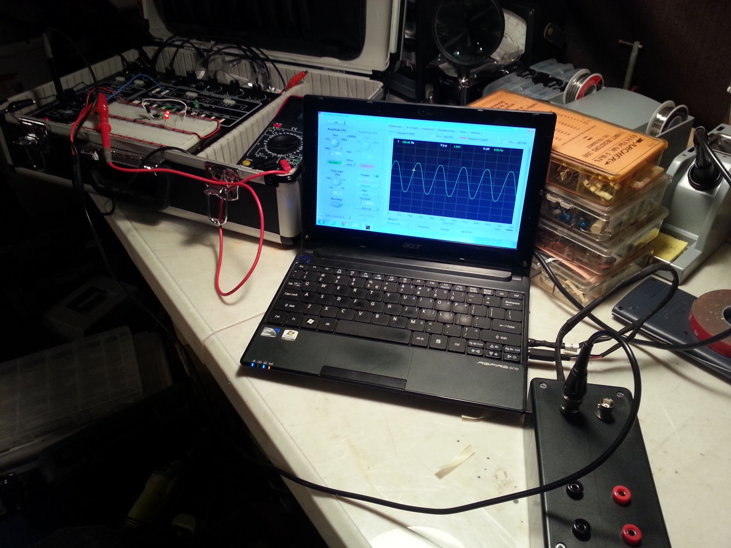

Step 5: Software
Now Plug it into your Computer, drivers should install now....
Next go to settings and set external soundcard as standart soundcard.
Now install / Start the software i am using Soundcard Oscilloscope by Christian Zeitnitz
http://www.zeitnitz.de/Christian/scope_en
The Software is very easy to understand, so I will not dwell on it.
