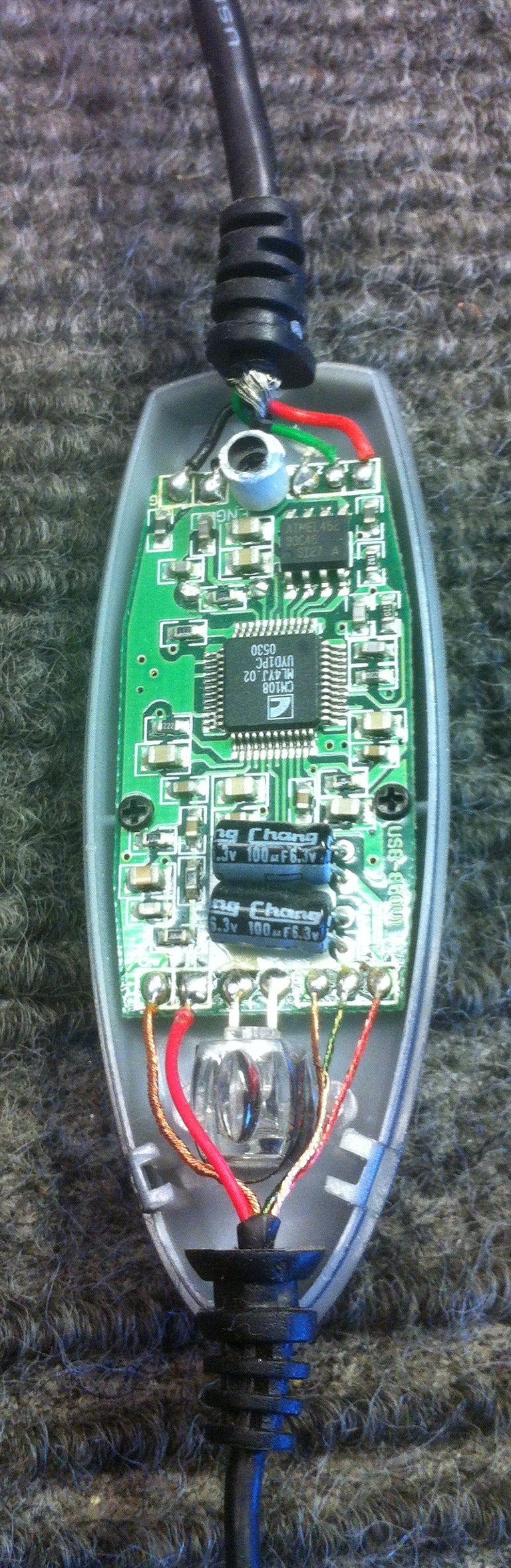

Step 1: The USB Headset Dongle
Most USB headsets have a "dongle" where the electronics live. The USB cable goes in one end (the top in this picture), and the analog audio lines go out the other (bottom in the picture).
To find the right connections, you have two options:
1) Cut the cable to the headphones and find the right and left audio output wires. An oscilloscope helps here.
2) Carefully crack open the dongle and find the connections on the circuit board. If your lucky, the pads will be labeled. My board said "R, L, and G", but I checked them anyway.
You want to make sure you don't have the microphone line because that's an input and not an output.
You may have to trace out the board with an oscilloscope to find the outputs. Also, for this step I like to send out a sine wave because it's easy to see on an o'scope. What I did is plug the USB end into a PC and run Audacity (a free audio editing program), which lets you output sinewaves. Audacity has Windows, Mac, and Linux versions.
In my headset, the wires to the headphone were too fine to solder, so I removed them and used a different cable. You'll need a 2 conductor wire with a shield if you replace the audio signal wires.

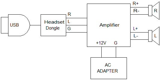

Step 3: Diagram
Here's a block diagram of the hookup. It's pretty basic. As I mentioned before, you can add a volume knob and several circuit enhancements using info on the DIY Audio forum.

Here's the final hookup. Some additional points:
1) The speaker output "-" termnials are NOT the same a GND. They can't be connected to GND nor to each other. That means this amplifier board cannot be used for headphones, which usually have a common ground for right and left speakers. if you buy the same board I used, it will come with warnings about this.
2) I had some noise and had to change the plastic box shown holding the dongle to a metal one. I also connected this case to GND on the dongle PCB. If starting over, it would probably be best to put the dongle inside the amplifier box. That would also make a neater set up, but would require a longer USB cable and bit more soldering.
