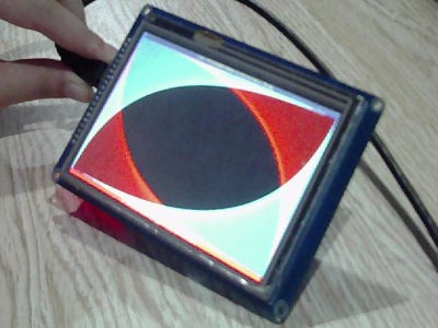

11. Upload the sketch until Done uploading appears
Step 4: Displaying

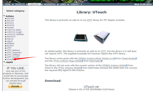

Step 5: UTouch Function Demonstration
If you want to demonstrate the UTouch function, download the UTouch from here , and the operation ways is the same as previous UTFT.
