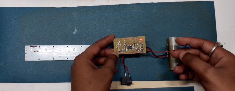

Now the main PCB of this project will be basically a Switching board in which when the button is pressed, MOSFET will turn on the UVC LED for a certain duration of time, and then the LED will turn off.
For Doing this task, I used an Attiny84 (for no special reason, any MCU can be used here).
I've attached Five small 0603 LEDs to Attiny84, Code basically turns the indicator LED on in a chaser sequence (from 1 to 5), and then we can press the button for Toggling the UVC Led, UVC Led will stay ON for around 10 minutes and then turn OFF

I first soldered all the SMD Components one by one and then added THT Components, you can watch this whole process in the youtube video of this project.

Before the final assembly, I added a lithium cell and a rocker switch to this setup and tested it for the first time.
after making sure that everything is OK and working properly, I moved on to the next process which is the final assembly!
