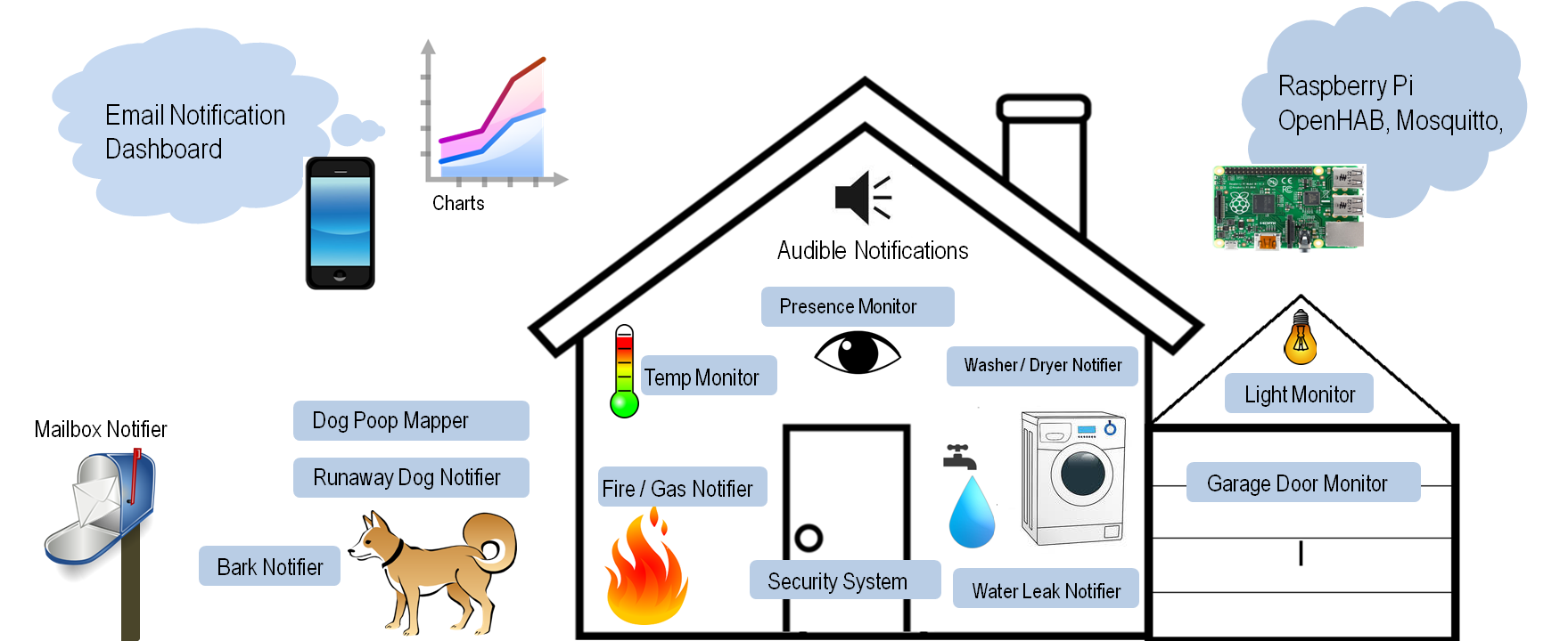

Here's the basic idea. With Arduino, it's really easy to connect boatloads of cheap sensors. Using this setup, that boatload of cheap sensors can now be on the internets. They can email you when things get too hot, too cold, too smokie, too gassy, or too bright. And your dog can email you by barking. You can also view the status of sensors on your smart phone. These sensor nodes are wireless, so you're not constrained by the location of ethernet ports.
Here's how it's put together.
This Instructable will be a tutorial for how to build a variety of long range wireless sensors, and how to integrate these sensors into a sophisticated open source home automation server. Aside from looking at a mobile app to see what's happening, you'll also receive timely email and audio notifications. This is a long Instructable, but you can jump to the sensor you're interested in building.

So, here's the list of sensors in this Instructable. I want to provide a home with the full range of human senses. Your home should be smart and sensitive.
Dog Bark (Any Loud Noise) Sensor
Get email notifications of loud noise. I use it to get an email if my dog barks in the kennel, so that I can open up my kennel webcam and see why he barked. There is also a counter to try to quantify how much he has been barking.
Washer-Dryer Sensor
Get an audio reminder when washer/dryer cycle completes - something like a "Washer Complete" announcement in the living room. No more forgetting laundry in the washer or wondering if it's done yet. Use the smart phone app to check if the cycle is complete or if the load has been picked up.
Light Sensor
Detect whether the light got left on or not. Displays the status of light on the smart phone app.
Area Intrusion Monitor
A PIR sensor monitors a room and sets off audio alarm / email notification when it senses a moving body.
Dog Tracker
Get notified if your dog runs away, track he's GPS location on google maps, and also map where he poops.
Gas/Fire/Smoke Sensor
Although this should not be the primary fire alarm, it can be used to send an email notification to you when the sensor senses smoke, fire, or LP gas commonly used in gas-powered stoves.
Temperature / Humidity Sensor
Temperature and humidity is reported to the mobile app. Optionally, you can enable email notifications when temperature dips below/above some preset value. Helpful for detecting furnace or air conditioner failures. You can also view a historical chart of temperature data using OpenHAB.
Water Leak Sensor
Get an email notification and audio alarm when a water leak is detected.
Just kidding, I got nothing for taste. I just like that picture. A couple more sensors that don't fit in neat categories.
Security - Door / Window / Drawer / Mailbox sensor
A battery powered reed-switch sensor that can set off an audible alarm, or send an email notification to your smart phone. Can be used to monitor doors, windows, mailboxes, or drawers. It also logs the time the event happened, as well as the remaining battery capacity on the sensor.
Garage Door Monitor
This is handy if you can't see your garage door from the house. Use a smart phone to check whether your garage door is opened or closed. You can also set it to play an audio reminder at, say 10PM, if the garage door is still opened.
With these sensors, everything from your dog to your washer & dryer can be part of the Internet of Things in a practical and useful way.

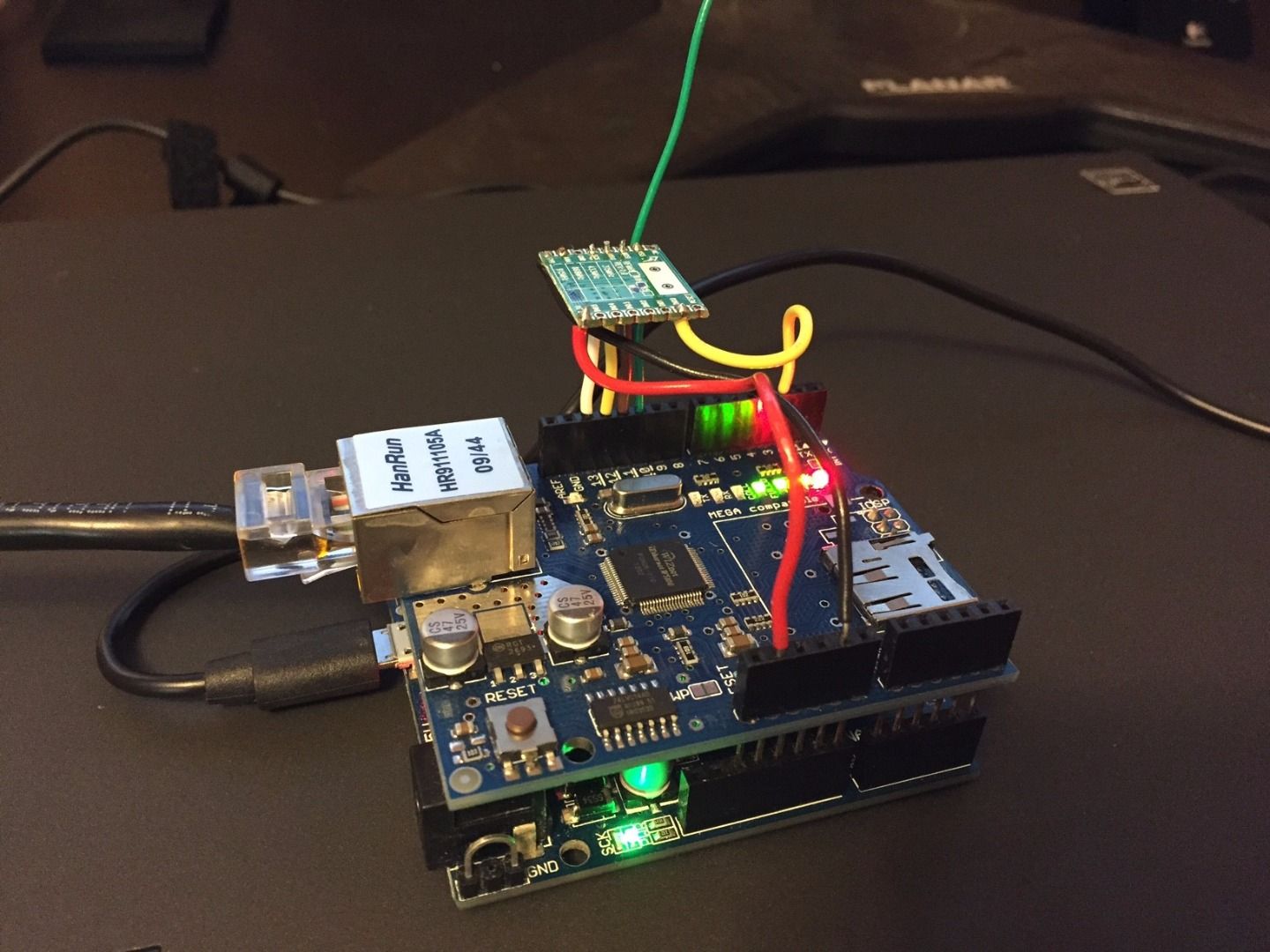

Once you have at least two RFM69 chips soldered with wires, we need to make the wireless gateway and setup the Raspberry Pi with OpenHAB. It's basically two Arduinos connected together using I2C. See the wiring diagram above and the instructions below. The communications path looks like this.
The wireless data is sent from the sensor node to the RFM gateway in the form of a struct. The struct data is then passed from the RFM gateway to the ethernet gateway using I2C (those two pairs of wires on pins A4 & A5). The ethernet gateway takes each individual piece of data from the structure and post it to the MQTT broker. The MQTT broker (Mosquitto) on the Raspberry Pi picks up this sensor data, and sends it to the OpenHAB program also sitting on the same Raspberry Pi.
Here's what the gateway looks like when you've got 22 gauge hookup wires connecting the two Arduinos. You can see the RFM Gateway Arduino on the bottom. It has the wireless transceiver mounted on it. On the top is the Ethernet Gateway with the ethernet cable connected.
Create Arduino Gateways
Components Needed:
- Two Arduino Uno Clones with 3.3V/5V switch set to 3.3V.
- One Wiznet 5100 ethernet shield
- One RFM69HW w/ wires soldered on
One Arduino will be designated the "RFM Gateway" and the other is the "Ethernet Gateway". On the RFM Gateway Arduino, wire up the RFM69HW like you see in the wiring diagram at the top of this step.
RFM69HW To Arduino
- NSS to Pin 10
- MOSI to Pin 11
- MISO to Pin 12
- SCK to Pin 13
- GND to Ground
- 3.3V to the 3.3V header
- DI00 to Pin 2 (interrupt)
Plug the ethernet shield on the "Ethernet Gateway". Hook together these two gateway Arduinos for I2C using male-male dupont cables, or just hookup wire if you have some around:
- Ground to Ground
- Analog Pin 4 to Analog Pin 4
- Analog Pin 5 to Analog Pin 5
Download the two gateway Arduino sketches above.

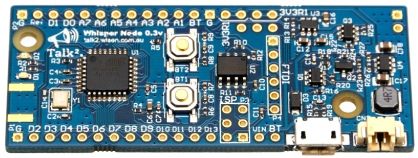

You could easily simplify lots of connections using this board: https://talk2.wisen.com.au/product-talk2-whisper-n...
It's an Arduino compatible board with RFM69 and is designed to run on AA batteries.

I wanted to also throw out there to the crowd that I do now have a working version of the RFM69 chip directly connected to the Raspberry Pi! I was able to use the information located here:
https://github.com/abouillot/HomeAutomation/tree/m...
I'm getting really low RSSI right now that I can't quite figure out (Typically around -100db when the two chips are only 3ft apart), but it's working! My antenna wire is about 3 inches on both, so thinking I need to give them larger antennas. Just need a minute to do some resoldering...
Reply 8 years ago on Introduction
Hi, I got it working too (yay!) but the same low signal strength as you report, did you get it higher? by resoldering?
Reply 7 years ago on Introduction
if you have the RFM69 at 433 MHz, you may want to use this antenna. Made a big difference for me:
https://arduinodiy.wordpress.com/2015/07/25/coil-l...
I did finally get my RSSI higher, but I'm not completely sure what the reason is yet. I have done two things - I updated the Gateway code for the raspberry pi and I purchased a mini wireless module from anarduino. I'm now getting around -25 to -30 RSSI. I purchased the new wireless module to help isolate the issue, since I then don't have to worry about soldering issues. I updated the Gateway code on the raspberry pi before I bought the module.
My goal is to move back to my pro micro module prior to putting this solution into production, but I'm planning on perfecting my code first so that I can focus later on just fixing the hardware.

thanks for your quick response! I actually never downloaded the files from GIT <ahem>, so copied those by hand in the ./piGateway folder. Had to reinstall MQTT for the 3rd time, now from a package (see here:
http://www.xappsoftware.com/wordpress/2014/10/27/installing-mosquitto-on-raspberry-pi/ )
AND had to enable SPI pins with help of Rpi-config... Now I'm looking at the msg
Listening at 915 Mhz...setup complete
connection refused
Not sure if the latter is because I don't have another RF69HW in place or something else, but slowly making progress :)
