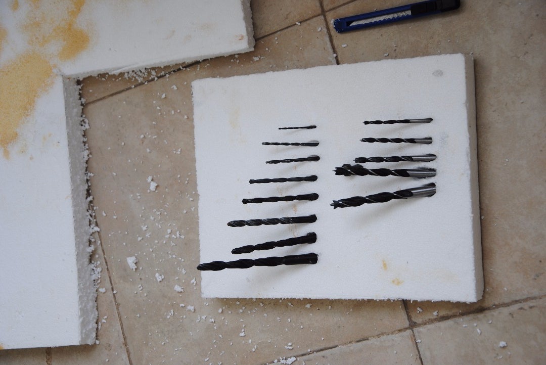

Step 3: Heat the Drill Bit & Make a Hole
I found out that sticking a drill bit into styrofoam doesn't work very well. The thick drill bits can't crush the styrofoam and make a hole. I tried to drill them in, But that only made the styrofoam crumble, So that was a fail too... I decided to try melting the styrofoam and it worked! Another good thing about melting it is that it coats the hole with hardened polystyrene, Which strengthens it a bit.
I chose to use a 2mm drill bit to make all of the holes for the drill bits.
First, I Heated the drill bit for around a minute.
After that, I inserted the drill-bit into the styrofoam at a ~30 degree angle. You should see the styrofoam melt and disappear when it touches the drill bit. Do this slowly and carefully, You don't want to mess up. For bigger drill-bits, I widened the hole a bit more, This is pretty easy to do

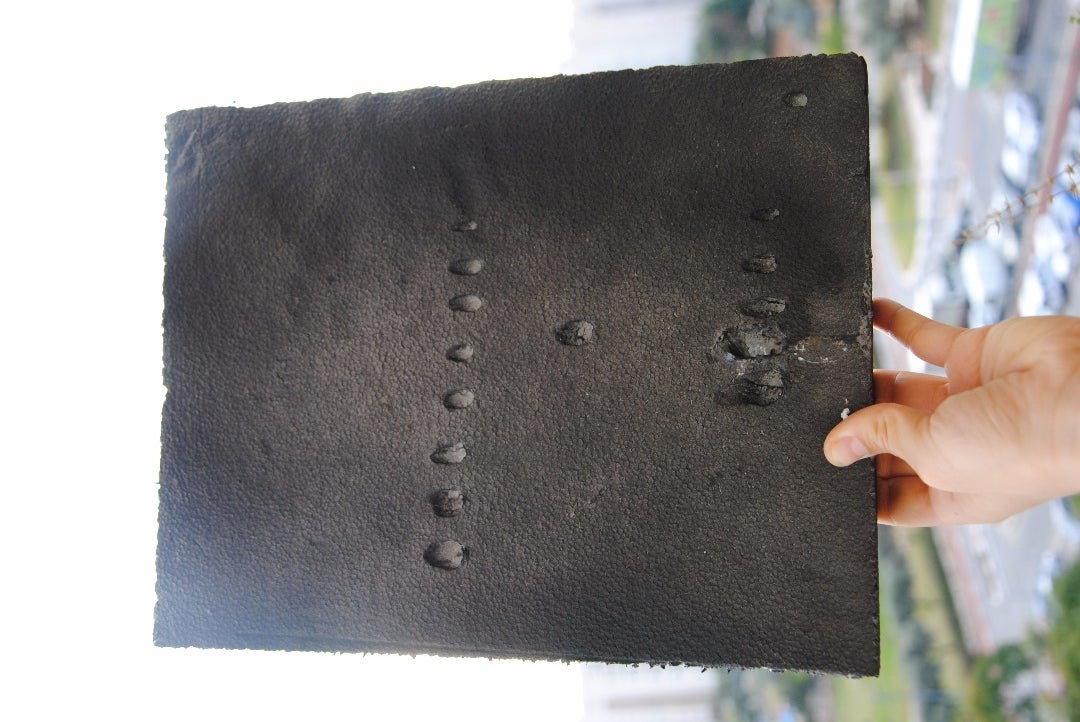

Step 4: Whoops, I Made a Mistake! | How to Fix It
If you made a mistake (I made only one), This is how you can fix it:
If it's a small mistake, You can fill the hole with PVA "Elmers School Glue", I tried that, But it wasn't good enough for me.
I decided to glue a tiny magnet* to the top of the hole with clear silicone adhesive. This worked well for me because my drill bit can get magnetized.
Now that it is straight, You can move on to the next step...
*I salvaged this magnet out a small speaker, You can salvage magnets from speakers for free too!
Step 5: Cutting the Styrofoam to a Good Size
First, I marked the size that I wanted it to be with a Sharpie, After that, I used a Utility Knife to cut the styrofoam to the size I wanted. To help cut the styrofoam straight, I used the ruler as a guide, Similar to how a fence works on a table-saw.

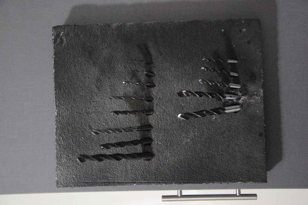

Step 7: Mounting It Onto the Wall (Closet... in My Case)

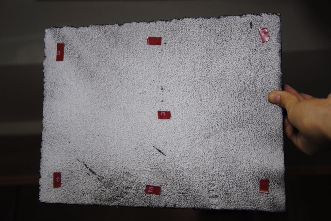

I put some double sided tape onto the back, And mounted it onto my closet. I think there are adhesives that are meant specifically for styrofoam, But double sided tape sticks strong to styrofoam.

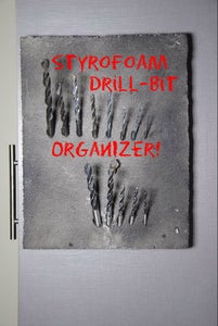

DONE!
