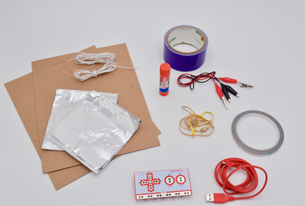

Makey Makey Classic, Chipboard, Foil Strips, Two extra long wires from STEM pack, Conductive tape, Duct tape, Glue stick, Rubber bands of varying sizes
Step 1: Create a Conductive Pad
Picture 1 shows the supplies you need. The extra long wires are in our STEM pack and you can use any conductive tape, but we used the tape from our Inventor's Booster Kit.

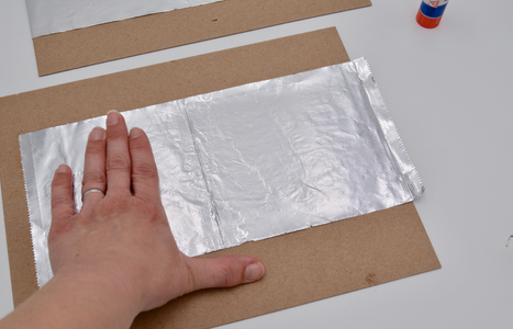

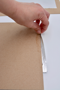

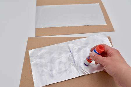

The first step in creating a conductive pad is to use your glue stick and adhere one foil square to one side of each piece of chipboard. (Picture 2)
Make sure you leave a little foil off to the right side so you can wrap the foil around the end of the chipboard. This will help us create a strong connection for Makey Makey. (Picture 3 and 4)

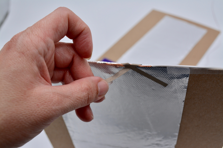

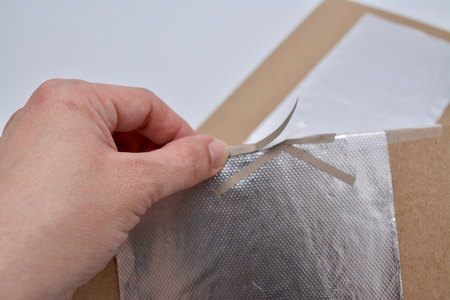

Grab the extra long wires from the STEM pack and tape one wire to the spine of the foiled chipboard with regular tape. (Making sure not to cover the exposed end with this insulating regular tape. Picture 1)
Now grab your conductive tape (pictured is from our booster kit) and tape the copper end of the wire to the foil on the chipboard. Use multiple pieces of conductive tape to ensure a good connection from the wire to the foil. Cover all of the exposed copper with conductive tape. (Picture 2 and 3)
This process will make sure the foil is conductive from the wire all the way across the foil length. Plus, it will hold our wire in place. Since you are going to be doing a lot of stomping, you want to make sure the wire will not move when you step on your stomping pad. Hiding the wire on the end of the chipboard ensures connectivity and durability, but it also makes it easier to keep the wires out of your feet's way!
Repeat this process for the other chipboard. Ensure that when the two pieces of chipboard are placed side by side with the foil covered ends, that the wire comes out in the same direction.

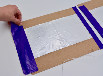

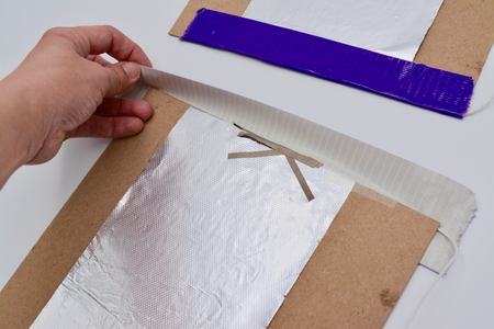

Cut two strips of Duct tape that will cover the short ends of your chipboard. (Our chipboard is about the size of a sheet of paper 8" X 11") Place half of the Duct tape on the outside of your chipboard and the other half over the foil side to cover the connection you just made. (Picture 1)
Place another strip of Duct tape other side of your chipboard. (Picture 2)

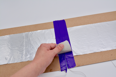

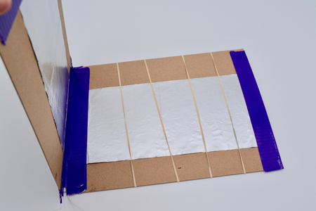

With your stomping pad open and the foil sides up, check to make sure you have both wires in the center and coming out the same direction like in Picture 3.

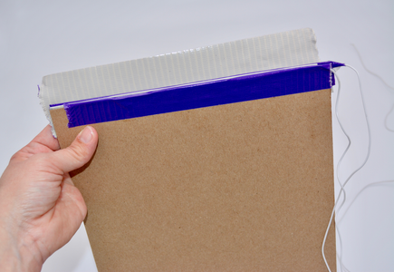

With the wires in the center, create a hinge to hold your stomping pad together by adding one piece of duct tape over your wire protection tape. Use one piece of duct tape on the inside of your switch and place another piece of duct tape on the outside of your switch for durability. (See Pictures 3 and 4)
If you plugged this into a Makey Makey at this point and closed it together, your stomping pad would always go off! When the two pieces of foil touch, it closes the circuit just like a switch. We'll need an insulator to break the circuit.

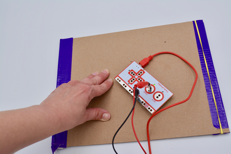

To break the circuit and create a switch, you'll need an insulator. Add an insulator to one side of your floor pad to keep the two conductive pads apart and your circuit open until someone “presses” your switch. (Or stomps on it!)
If you use rubber bands, you can tinker with making a weight sensitive floor pad once you hook up a Makey Makey.

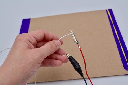

Let’s connect those wires to Makey Makey and test your floorpad switch! Connect a black alligator clip to one wire and a red alligator clip to the other wire. (Picture 1)
Now connect the black alligator clip to earth on your Makey Makey and the red alligator clip to the space input. (Picture 2)
(NOTE: You don’t have to color coordinate, we just find it’s easier when explaining how to do stuff.)
Let’s test our stomping pad for weight sensitivity. Stomp on it to see if you are Makey Makey-ing connection.
The more rubber bands you add, the harder you'll have to stomp to make a connection. If your switch isn't working, then take away some rubber bands. Or if it is too sensitive and connecting too much, then add more rubber bands to add insulation between the two conductive pads.
