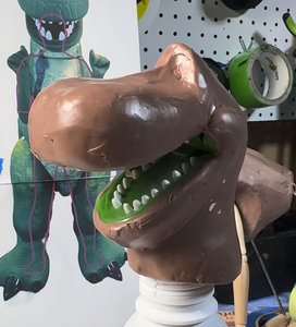

Step 1: Sculpt the Basic Shape
Start by using clay to sculpt the basic shape of Rex on a 12-inch posable wooden human figure. Focus on creating the head, legs, and body. Take your time to get the proportions right; this will serve as the foundation for your costume.

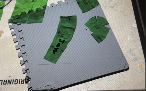

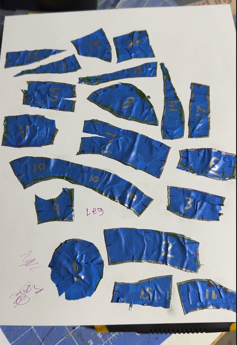

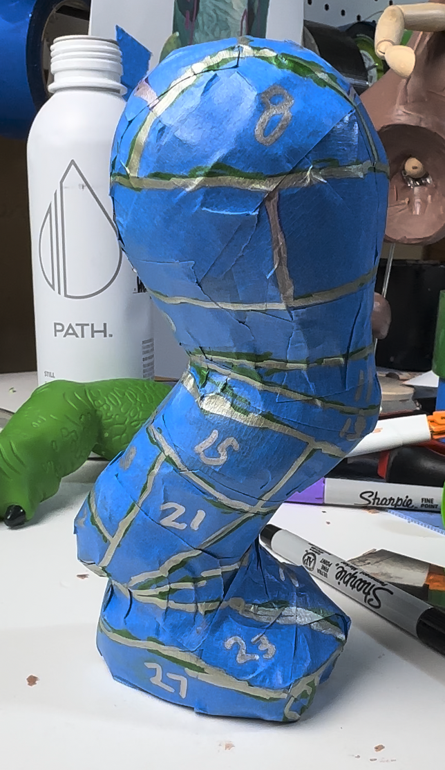

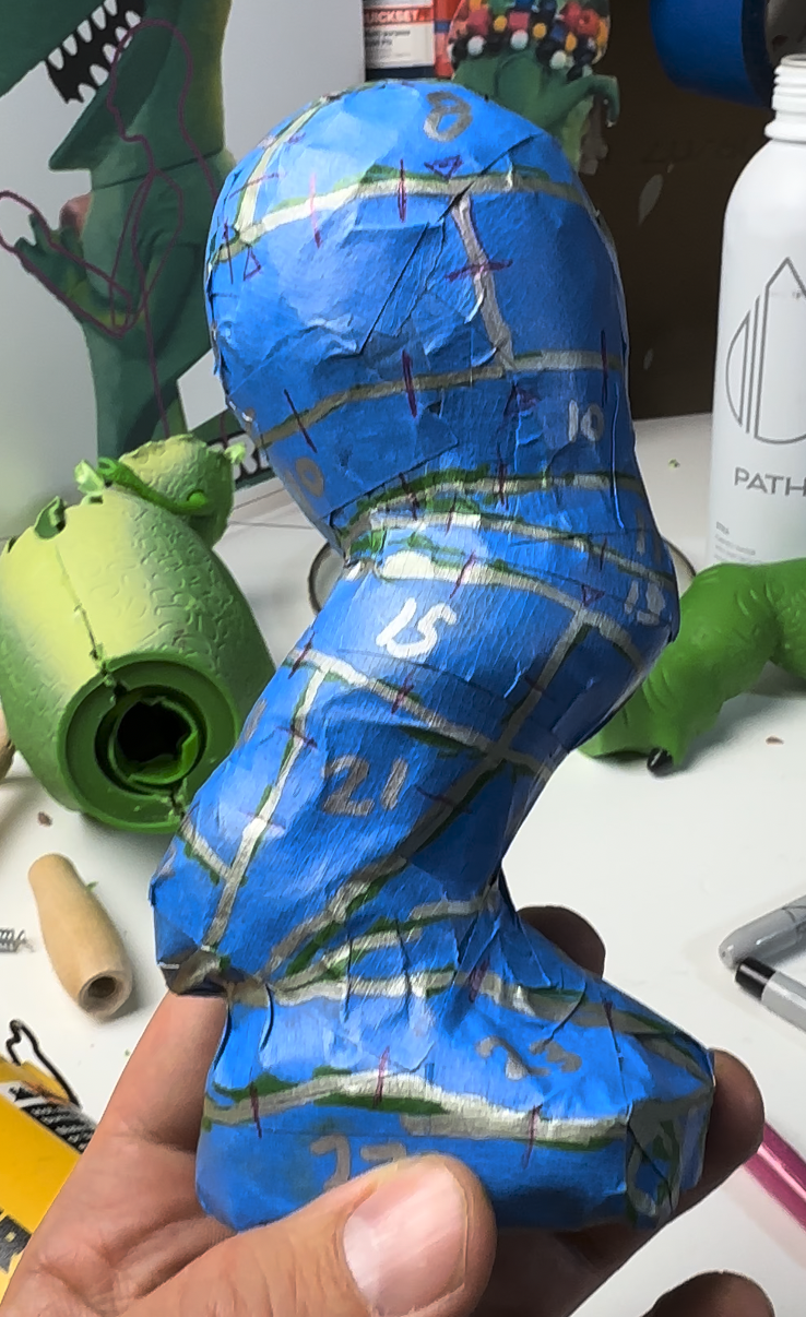

Step 2: Create a Tape Pattern
Once your sculpture is complete, cover it with masking tape. Make sure to wrap it snugly to capture all the details. Carefully cut the tape off in a way that creates a flat pattern. Lay this tape pattern onto a piece of paper and scan it into your computer to create a digital template.

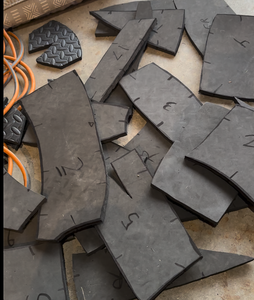

Step 3: Project the Pattern
Using a projector, display the scanned pattern onto the ground or a large wall. Adjust the size as needed, then trace the pattern onto EVA foam. This will serve as the base material for your costume.
Step 4: Cut and Assemble the Foam
Carefully cut out the traced shapes from the EVA foam. Use contact cement to glue the pieces together, forming a full-scale 3D version of your pattern. Ensure everything aligns properly as you build up the costume.

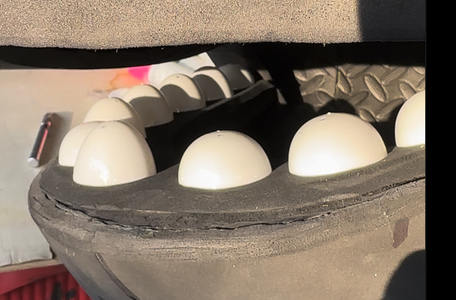

Step 7: Create the Illusion of Teeth
To give Rex a toothy grin, glue plastic Easter eggs along the jawline. Position them carefully to create a convincing appearance of teeth.

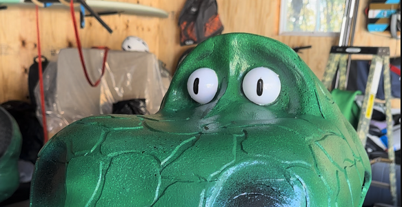

Step 9: Craft the Eyes
For the eyes, use more plastic Easter eggs and draw pupils on them. Secure them into place to complete the facial features.

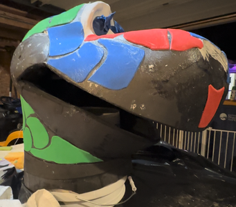

Step 12: Seal the Costume
To protect the foam and add durability, spray the entire costume with aerosol flex seal. This will also help create a smooth surface for painting.
Step 13: Base Coat With Green Paint
Once the flex seal is dry, paint the entire costume green. Use acrylic or spray paint, and apply multiple coats for even coverage.
Step 14: Add Texture Details
Using other colors of paint, add texture and details to your costume. Consider using sponges or brushes to create different effects and depth.

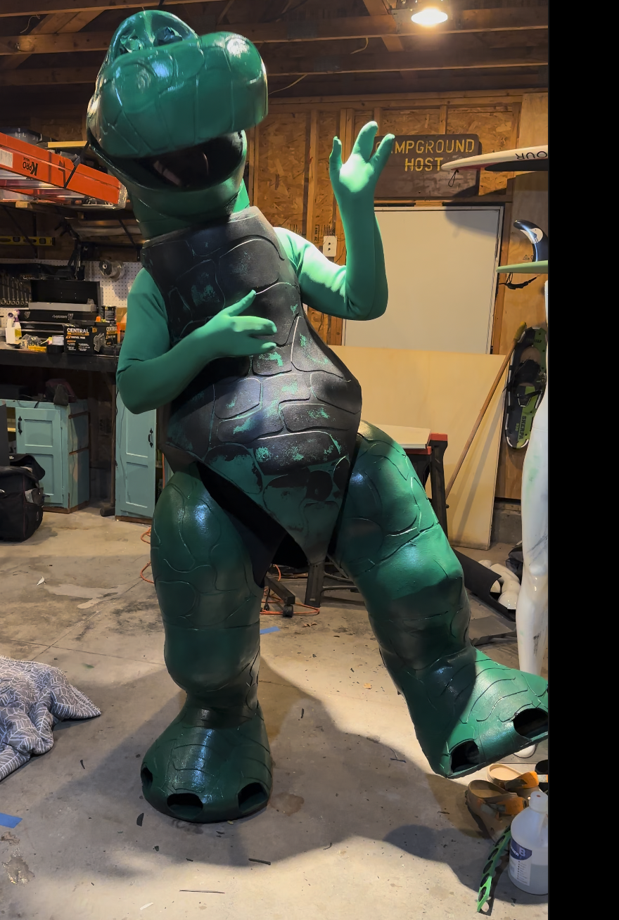

Step 15: Get Into the Costume
To wear the costume, climb in through the bottom. Ensure that everything feels comfortable and secure before final adjustments.
Step 16: Attach the Head
Place the head onto the body, aligning it carefully. Make sure it fits snugly to maintain the overall look of the costume.
Step 17: Step Into the Legs
Finally, step into the legs of your Rex costume. Once everything is in place and secure, you’re ready to show off your creation!
