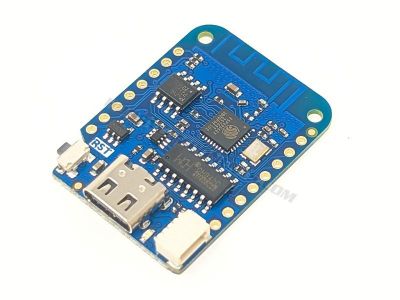

3x Wemos LOLIN D1 Mini ESP8266

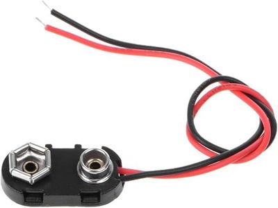

2x Battery Clip Connectors (JSGHGDF PP3 9V Battery Clip Connector)

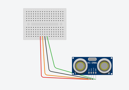

Connect your ultrasonic sensor to the breadboard as illustrated in the images.
Solder your WEMOS Chip to have female connection ports into 5V, G, D4 & D3.
Red wire goes into the 5V of the WEMOS Chip
Orange Wire goes into D3 of the WEMOS Chip
Black Wire goes into D4 of the WEMOS Chip
Green Wire goes into the G port of the WEMOS CHIP (Changed from black wire in physical model for clarity)
Connect the WEMOS into your computer via USB and run the appropriate code found in the linked Instructable:

Solder male wires onto the voltage converters at the 'out' end of the converter end (Red for positive, Black for negative). Then solder the battery clip connectors to the 'in' end of the board (Red for positive, Black for negative). Attach this to the breadboard with the positive wire connecting parallel to the 5V wire and the negative wire connecting parallel to the G wire. Once you have uploaded code you can remove the wire, and once a battery has been attached correctly (see image) the sensors will function remotely.
