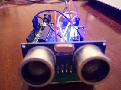

This is a simple example of using the ultrasonic sensor (HC-SR04) in Arduino where we will turn on a led with the variation of distance and print the distance from an object to the serial monitor.
I had made the time for the light to shine longer than the original one. This function made my idea of work better.

Step 1: All the Necessary Components
Step 2: Connect the Components
