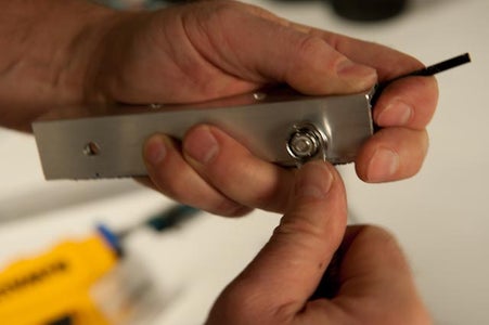

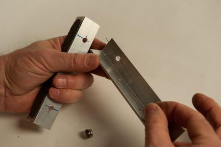

Step 2: Step Two: Build and Install the Camera Mount
Deburr and clamp the two 6” lengths of aluminum angle into a “C” shape as shown. Drill a ¼” hole 1” inch from either end of the lengths. Bolt together. As they are put together lay the fine floral wire into the valley of the rear length of aluminum. This will function as a shim to “open” the “C” a little and compensate for the angled side of the water tight box. This will level the camera in the box and aim the camera lens straight down the lens housing.
Set the mount into your box and mark the locations for the mounting screws on the box and the aluminum mount. You want the camera to sit as close to the closed lid as possible without interfering with the water tight seal or the lid latches. Also with the aluminum mount in the box hold your camera body (without the lens mounted) centered in the box and mark the location of the tripod mount on the bottom of the camera on the aluminum mount. Drill the holes, trim and attach the rubber grip tape (make sure to drill out the grip tape for the tripod mount screw) and dry install (without any silicone) the aluminum mount into the water tight box. If using the Black Rapid FasteneR-2 cut the bail off and set the fastener into the hole in the mount. I use a small allen wrench inserted into the bail holes to tighten the fastener into the tripod mount on the camera. Depending on where the tripod mount is located on the bottom of your camera the nut and bolt that hold the camera mount into the box and the fastener used to mount the camera might run into each other. That one you are going to have to work out on your own.
Dry install (no silicone) the camera mount into the box. Install it in this order: screw, metal washer, small rubber washer, box, large rubber washer, aluminum angle camera mount, small rubber washer, metal washer, lock nut.

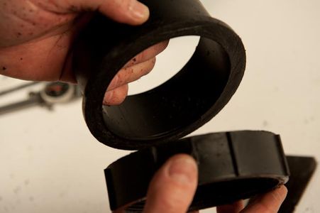

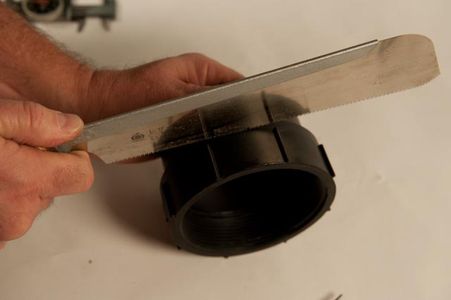

Step 3: Step Three: Prep, Cut and Install the Lens Housing
It is time to chop up some ABS. I cut mine with a dozuki back saw. I like the control it gives, the blade (kerf) is very thin and those suckers are sharp! These cuts can also be made on a chop saw, but this is super dangerous and I don’t recommend it. Or with a jig saw. Though safer, tends to wander a bit. The cuts can also be made with a dremel installed with a cut off bit. Do what you are comfortable with and keep in mind that the cleaner cut means less work sanding afterwards.
Here is where the written instructions might get a little confusing so follow the pictures and hopefully you will get through this part without another trip back to the hardware store.
4” female thread / female slip ABS fitting: From the slip side measure to the valley of the slip, mark that distance on the outside of the fitting. Cut and discard the female slip portion of the fitting. Sand flat and de-bur the cut surface.
4” male thread / female slip ABS fitting: This fitting will be used as is, with out modification.
4” male slip / female thread ABS fitting. Measure to the bottom of the female thread and mark that length on the outside of the fitting. Cut and discard the female Thread portion of the fitting. Sand flat and de-bur the cut surface.
The ABS fittings are now ready to install into the box. Next step prepare the box to receive them.

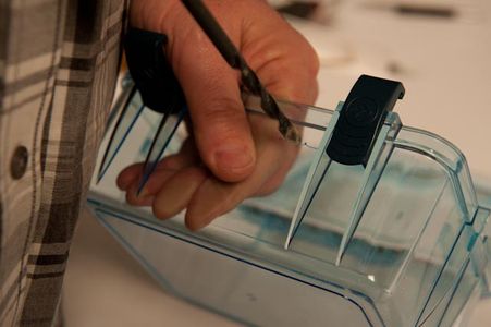

Step 4: Step Four: Mark and Cut/drill the Opening for Shutter Release and Lens Housing
Install the camera body (without lens) into the box and mark the center of the lens mount and the shutter release. Make sure the camera is mounted square to the back of the box. The slightest bit of slant could put the shutter release in the wrong spot.
Remove the camera body from the box and drill a 5/8” hole centered in the cross hairs at the shutter release. Set the male slip fitting centered on the cross hair on the bottom of the box and mark the outside diameter. Drill an access hole and cut out for the fitting. Tradition teaches you to “cut inside the line” but because of the taper on the male slip, it is larger at the base than it is at the end so “cut on the line” and it should be just right. I cut mine with a jig saw but a dremel with a cutting wheel would work fine too.
Test fit the fitting into place and carefully enlarge the hole if/as needed. Clean up the edges with a little sand paper.
Depending on your camera and the location of the lens opening on the body it might be necessary to remove the camera mount in order to install the fittings into the box.
“Dry fit” all of the parts before you start spreading silicone. If glitter is the herpes of the craft world then silicone is the herpes of the construction industry . . . . . . that and fiber glass insulation.
Once you have checked for fit you are ready to install them into the body of the housing.

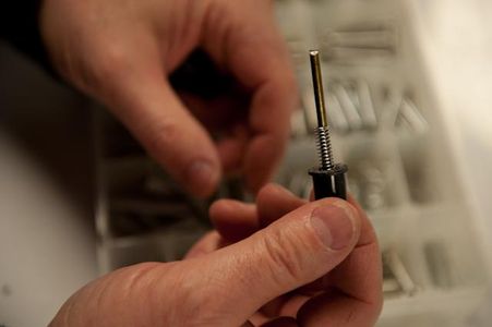

Step 7: Step Seven: Make the Shutter Release Switch
Now it is time to make the shutter release switch. Begin by pulling the black plastic thing out of the bottom of the switch assembly. Remove and chuck the guts. Keep the metal and rubber cap, the part with the threads and the black plastic thing you just pulled out of the back of the switch. Remove and discard the contact screws from the back of the plastic base.
Now take the button part of the switch and with JB Weld, epoxy the 16d nail into the center of the back of the button. It is important that the nail is centered on the switch and that there is a little space left in the switch for the spring to compress into. The nail will be cut to length after the switch is dry fit into the box. So for now leave it long and use the length to “site” for plum, level and square. (In hind sight, the 16d nail is the only non-chrome or stainless steel part in the housing and true to form it is the only one that rusted. If a stainless or hot galvanized or even a copper roofing nail can be found that might be a better choice. Just remember that it will need to be “trimmed to fit” but that could be done with a cut off wheel on a dremel easily enough so go for it!
So back to it! Drill a hole in the black plastic switch back just large enough for the nail to slide through. Now drop the small pusher spring on to the nail. The spring when compressed should mostly fit into the space left from not completely filling the push button with the JB Weld. Without seating the back into place test the switch to see if it works and does not bind. It should move easily and freely up and down. Adjust as necessary. The first time I did this I had too large of a spring and seated the switch back into place only to find that I had no “throw” left in my switch and had to tear the switch back apart to make the change. I found that the smaller springs provided for a better “feel” of the shutter release on the camera.
With the button and its nail in place and the proper spring installed, snap the back into the switch and dry fit the switch into the 5/8” hole in the housing with two of the 5/8” hose washers. Now with the switch in place set your camera on the mount and sight and mark where the plunger (the 16d nail) needs to be trimmed. I cut mine right in place with a pair of line mans pliers and then filed the end smooth with a hand file. Set the camera in place and see if it works! Trim again if it is too long and if you cut it too short smack yourself in the head and start again.
