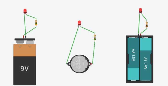

Activity 2 Protect the circuits by adding Resistance

Now, we will calculate the required resistance for all three circuits.
For circuit I
V= I*R : where LED forward Voltage =2V and current rating of LED 20 mA
V=Vs-Vf = Source Voltage - Forward Voltage of LED= 9-2 = 7V
7 = I*R
Putting the value of LED current
7=(20/1000)*R
Solving it we get
R= 350 Ohm
Similarly solving for Case II and Case III we get Resistance 50 ohm
Now, let’s see how current affects our circuit by adding a resistor in series with the LED.
As you can see, adding a resistor in series with the LED reduces the current flowing through the circuit. This is because the resistor opposes the flow of current. The larger the resistance, the smaller the current.
 After adding the required resistance, you will see that all three LEDs are glowing with equal brightness.
