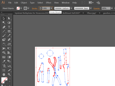

Step 12: Coloring the Lines (cutting)
Highlight your lines to be cut.
Set 0.001 to the stroke box on the top toolbar.
In order to cut, two conditions need to be satisfied with the lines. Its line weight needs to be set to 0.001 pt. and it needs to be colored red.
Step 13: Coloring the Lines (cutting Cont.)
Highlight the lines you want to cut.
Double click on the "Stroke" box to open the color menu, as in step 11.
Set the RGB values to 255, 0, 0 respectively.

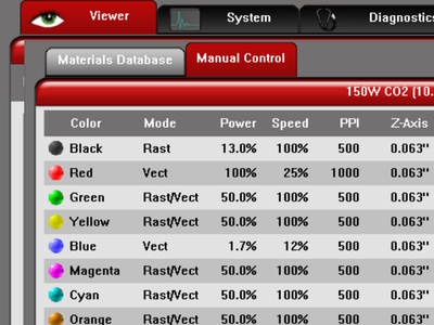

Step 21: Changing Laser Power and Speed (for Experienced Users)
Click on the "Settings" button.
You now have the option to either operate the laser under the recommended power and speed settings based on the material you selected earlier or change these settings yourself. Only change these settings if you have experience cutting the material. You should be under the "Manual Control" tab and see a list of colors with assigned "Power," "Speed," "PPI," and "Z" values.
Depending on the color you used for your lines, change that color's "Power" and "Speed" settings.
Click "Apply" and "OK" when finished. You should not need to change the "PPI" or "Z" settings. Note that higher power and lower speed means a deeper cut. Be careful, as this can lead to deformations due to melting and/or fire.
