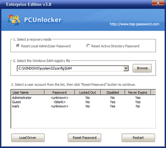

Once your computer boots from the CD, the entire Windows PE boot image will be loaded into memory. After the booting procedure is complete, you'll see the PCUnlocker program. It automatically searches for your Windows SAM database on your local hard drive, and then show you a list of local user accounts for your Windows installation.
From the list box you can find out which user account is locked out, disabled or password protected. Choose a user account with an expired or forgotten password, and click on "Reset Password" button. The program will remove your forgotten Windows login password, set your password to never expire, and unlock your locked or disabled user account.

    i sekect the SAM registry fike but it says "unable to read sam database [X:\WXPE\SYSTEM32\CONFIG\SAM]"
    0
    petemag
    petemag
    Reply 7 years ago on Introduction
    The X:\ drive is the bootdisk of PCUnlocker. You need to choose the SAM file on the system partition of your local hard drive.
