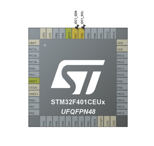

Step 3: PIN Mode Selection
Select Pin B6 and B7 for SCL and SDA respectively
Step 4: I2C Configuration
Configure the I2C mode to I2C under Connections Menu

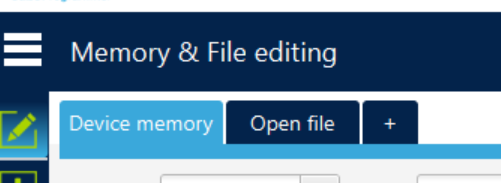

Step 9: Open STMCubeProgrammer and Connect to STM Board Via USB
Step 10: Click on Open File and Paste the Copied Path
Step 11: Go to Download Options (Found in Toolbar on the Left)
Step 12: Change Download Options and Click on "Start Automatic Mode"
