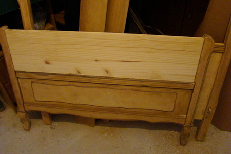

Step 2: Preparing the Additionnal Pieces of Wood
I have used the MFP multifunction to make my cutting boards that will come fill the space formerly dedicated to bars.
Here boards 22cm on 90cm.
Then place to drill two holes on each side, top and bottom with a drill diameter of 4 to 5 wood screws dia.
Then book these boards and go al step 3

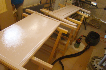

Step 3: Let's Paint
And presto, it's gone, with my dear paint gun PFS 105 the dilution is prepared, and this is part for painting =)
