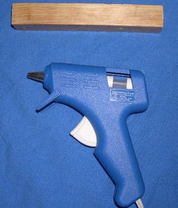

Ideally, you will need the following items:
Small Phillips Driver
Small Flat Screw Driver
Plastic iPod Opener Tool (optional)
Popsicle stick or other flat wooden stick
Hot Glue Gun
Xacto Knife or Razor Blade
Fully ATA compatible Compact Flash Card (2Gb min)

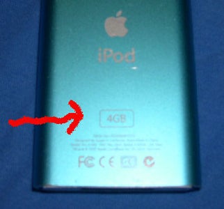

2nd Generation iPod Mini. If you use an iPod with a bad drive, just make sure that the unit is otherwise fully functional.

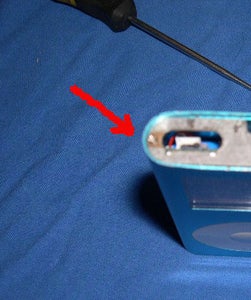

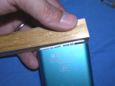

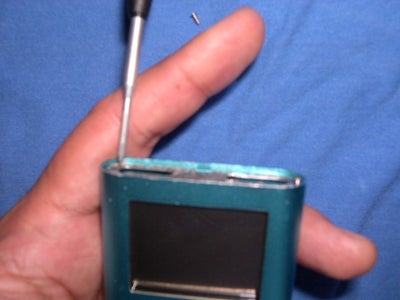

Unlike the standard iPods which have two halves, the shell of the Mini is a single piece of aluminum with covers on the top and bottom.

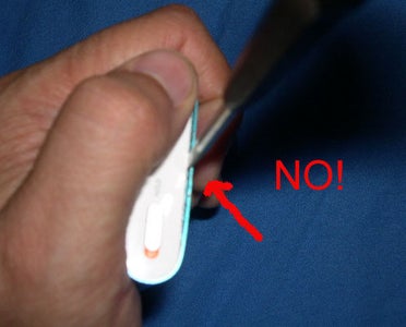

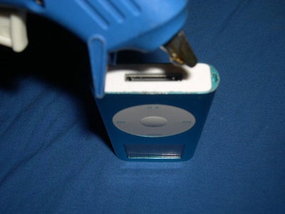

Although you could use the "brute force" method of prying open your iPod with a screw driver, there is a little-known but very elegant way to open your iPod that will leave virtually no signs that it was ever opened!

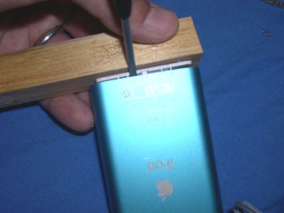

First, put your iPod on "hold" by sliding the switch. Heat up the glue gun and place a small amount of glue on the top cover and glue the stick to the cover.
Don't worry, the hot glue, when dry will come right off without leaving a mark!

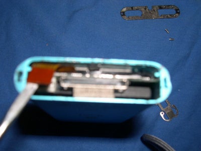

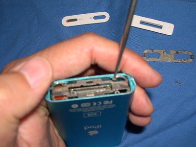

Once the top and bottom covers are removed, taking the iPod apart is easy.

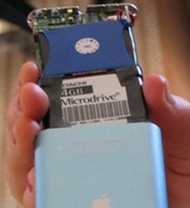

Carefully slide the complete assembly out of the case by pushing from the bottom with your finger.
Step 4: Replacing the Hard Drive

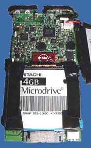

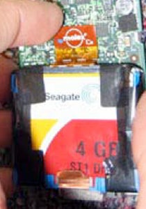

Using your iPod tool or other flat instrument, disconnect the hard drive connector from the motherboard by pulling the connector up from the back of the ribbon cable as shown. If you pull from the side, you risk tearing the connector from the ribbon cable!
Take your Xacto knife or razor blade and remove the tape and plastic bumpers from the hard drive. Be careful not to damage the ribbon cable in any way. Now remove the connector from the hard drive pulling slightly from one side and then the other until the pins come out completely.

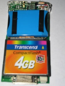

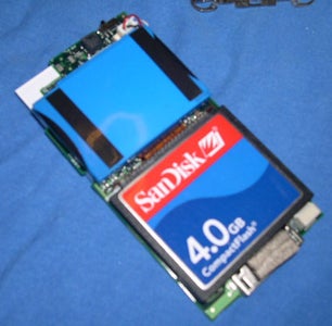

Now take your ATA compatible CF card and plug into the HD connector "face up" just like the hard drive.
You don't need the rubber bumpers or tape but you will need a small piece of double sided foam tape to attach the card to the motherboard and keep it from rattling around inside your Mini.

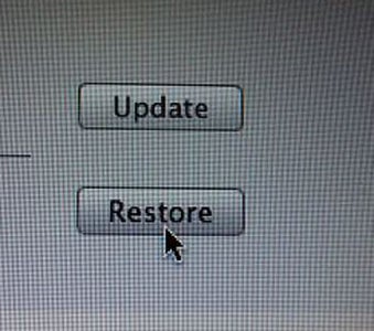

Step 5: Restoring the IPod's Firmware
Place the "naked" unit face up on a non-metallic surface and plug into your computer. Either a USB or Firewire connection will work.
Once iTunes is up, allow the program a couple of minutes to recognize the iPod. After recognition, iTunes will ask you if you want to restore the "defective" iPod. Click yes and iTunes will restore the iPod.
Once restored, the iPod will restart and iTunes should recognize the new iPod! Download a couple of songs into the unit and eject the iPod. We're almost done!

Great tutorial. I couldn't get mine recognized in iTunes or in disk mode until I realized that the CF card fits "backwards". After opening up the mini again and flipping the CF card, it worked like a charm. I used Transcend TS8GCF133 8 gig and when inserted correctly, the orange Transcend label faces out from the board.

On the geektechnique.org
site, the 4th comment states that this only works on an iPod Mini 2nd
generation. Whereas in the “Ideally, you will need the following items” section
of this site, it implies that a 2nd generation is needed. Which is
correct?
6 years ago
I'm confused, would this work on a second gen Mini? Some of the comments below seem to indicate that 2nd gen Minis are incompatible with CFs.
Reply 1 year ago
I did it on 2 2nd gen minis with no problems.

Just completed the mod. Restore is TOTALLY impossible with a computer running Windows 7. Dont throw away the ipod mini. After weeks of frustrating efforts, I tried with an old computer running XP and iTune 11.4.0.18 and it worked flawlessly.
Reply 1 year ago
not sure what the problem you encountered was (iTunes maybe?), but I did this same mod some years ago with 2 iPod minis (2nd gen), Win-7, with absolutely no problems. My big concern now (I just pulled them back out after a few years of sitting in a drawer) is the latest iTunes. I hear it may not play nice with older iPods. Fortunately, I think I should still have an older version socked away...
