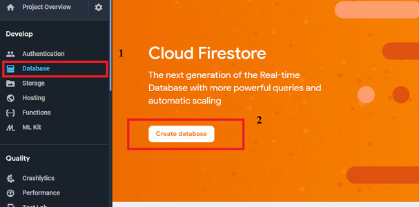

Step 1: Log in to Firebase console console.firebase.google.com/console/loginusing your Gmail account. Click on "Add Project".
Step 2: Give a project name and accept the terms and click to "Create Project".
Step 3: After creating project go to Database tab and select Create database.
Step 4: Choose Start in test mode and click to Next.
Step 5: From Database drop down choose Realtime Databse.

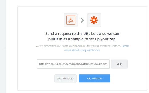

Step 5: Choose Catch Hook and click on Save+Continue.
Step 6: A unique webhook URL will be created for you. Copy the URL to the clipboard. Without closing the tab open a new tab form the browser and open Particle console.
Step 7: Initiate a new webhook creation from the integration tab.
Step 8: Fill up all the field. Paste the Zapier webhook URL to URL text box form the clipboard. For the Request Format select JSON.
{ "temperature": "{{temp}}", "humidity": "{{humid}}", "air quality": "{{air}}", "sound level": "{{noise}}", "latitude": "{{lat}}", "longitude": "{{lng}}", "published_at": "{{PARTICLE_PUBLISHED_AT}}" }
Step 10: Click on CREATE WEBHOOK
Step 11: After creating the hook click on TEST to send a test request to Zapier.
If everything goes well you will get the following message.
Step 12: Go to the previous tab from browser and click on Ok, I did this button as you sent a test request from Particle cloud.

You will observe the following output from Firebase console. This is for the PUT method configure in webhook. Without creating any row data is just update.
The following result is observed for the POST request. Every time firebase receives new data it stores in a new row. This may be helpful if you like to export the data.
Zapier saves the data in Google sheet and for every data received, a new row is created. You can also show the graph on the sheet.
