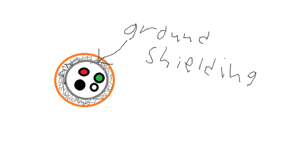

Next you need to strip the main cable so that you can easily access the color wires.
Also strip the colored wires so we can move on to the soldering process.
Note: the first layer of the wire is covered in ground shielding wire DO NOT connect it to any of the colored wires. You may connect it to the strands on the other wire if you would like to but make sure that you properly do everything else first
