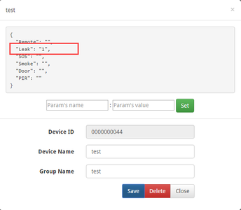

Till now, we added water detector successfully to the zigbee gateway.
Now we can observe the status of the water detector on www.linksprite.io web portal. Water detector is a water leakage detector, when we place it on the place that has water, we can see status change on the web portal.

Press the RST button of the sensor until green LED blinks fast.Press Linker button to add the deviceWhen the script adds the device, and obtain the zone type information, the device has been added successfully.Now the gateway can obtain the sensor information and report to linksprite.io.
