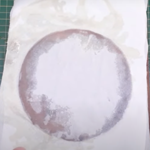

Place one of the non- stick papers on the wooden board and your dry and treated SCOBY on top of it.
Step 3: Adding the Wax
Then cut a piece of the beeswax sheet slightly smaller than your SCOBY sheet.
It's better to have too little beeswax and add more later, than too much.
Step 4: Covering the Set With Non-stick Paper
Now cover everything with the other sheet of non-stick paper.
Step 5: Melting the Wax
Put the iron on a low temperature and start ironing over everything until the wax melts.
Step 6: Impregnating SCOBY With Wax
When the wax is completely melted, use the roller or tube to press the wax against the SCOBY to make it waxed.
Step 7: Doing the Other Side
Then turn the paper/SCOBY/Wax/paper set over and do the same on the other side.
This is usually only necessary if your SCOBY is very thick.
Step 8: Cooling Down the Waxed S.C.O.B.Y
Now allow it to cool down and remove the sheets of paper from the waxed SCOBY.
Once cooled you can use it.
