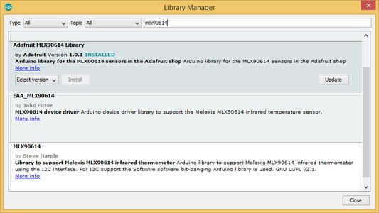

Step 2: Prepare Library MLX90614
for library MLX90614 i use adafruit library, you can Open Arduino IDE and menu Tools -> Manage Libraries -> search MLX90614. and click Adafruit MLX90614 Library then click install in Library Manager
