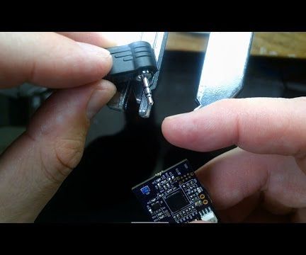

Step 2: Prepare the Switcheroo Board
Most garage opener remotes use a 3v coin cell or 2 AAA batteries that are each 1.5v, adding up to 3v. In this example, the remote runs on 2 AAA batteries, which the Switcheroo can use without the need for the 3.3v regulator. Additionally, you won't need the 3v coin cell battery clip either. You will prep the Switcheroo by soldering a set of bridge wires to the back to enable the use of the power input through-holes without the regulator.
The first thing you'll want to do is enable the unregulated power through-holes on the side of the Switcheroo to accept 3v power from the remote. To do this, solder the unregulated voltage pad for the 3.3v regulator to the 3v battery clip pad.
Once you've bridged those two pads, now you'll want to connect the negative sides of all the outputs to ground pads. Because the remote and Switcheroo are sharing the same power source, we can cut down on the number of wires you'll have to solder by using the common ground to your advantage.

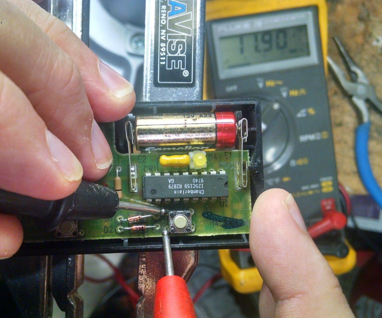

Step 3: Prepare the Remote Control PCB
The first thing you will want to do is solder a pair of hookup wires to the 3v power supply inputs on the PCB. In this example the 3v inputs are at the top of the PCB.
Now look carefully at the remote control PCB. In this example, it is clear that the PCB was designed with 18 different switch pads on the PCB, even though the button insert only seems to indicate 4 total buttons. The reason manufacturers do this is to try to use the same PCB for multiple products, and they just change the plastic and rubber bits around it. The trick here is to figure out which switch pads are used for this particular application. It's pretty easy to work this out by setting the top case with rubber button contact pad next to the PCB and line up the button pads with switch pads.
Once you've got the correct switch pads on the PCB identified, use a continuity meter to test the switch pads. Each pad has two exposed copper or metal elements, one of which should be ground. You will want to solder a good length of hookup wire to the element which is not the ground side of the switch pad. Also use the meter to ensure you've not created a solder bridge across the switch pad elements.

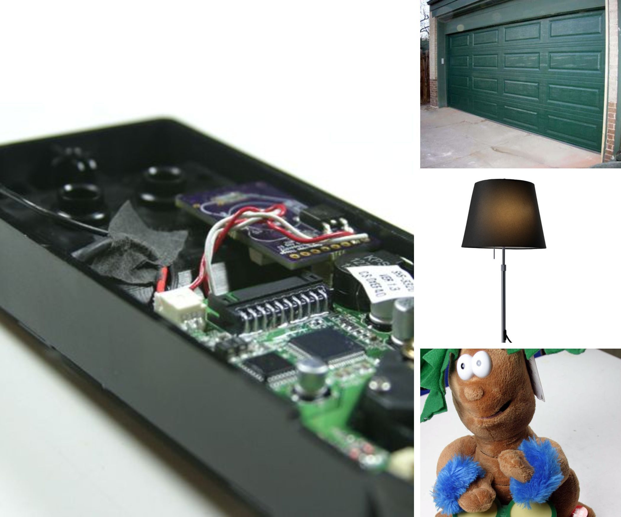

Step 4: Connect the Switcheroo to the Remote Control PCB
Place the Switcheroo over the remote control PCB and measure the wires you've soldered to the remote control PCB so you can trim them down to a reasonable length.
Solder the power supply wires to the input through-holes of the Switcheroo.
Solder the switch pad wires to the + side of the outputs of the Switcheroo. In this example you bridged the - outputs to the ground pads for all four outputs, but on this remote there were only 3 buttons. Adjust accordingly.
Step 5: Finish It Up
Optionally, you can liberally apply silicone sealant between the remote control PCB and the Switcheroo board, then press it down over the wires. The wires will keep the two PCBs from shorting out on each other, and the silicone will keep the whole thing together.
Remove the rubber button pad section from the top case and place the case overtop.
Hang the finished unit from the inside of the garage door using sun visor clip placed over the rolled steel hinge. As the door opens, it will simply go up with the door.
Now when you drive up to the garage door, your phone can open the garage door!
