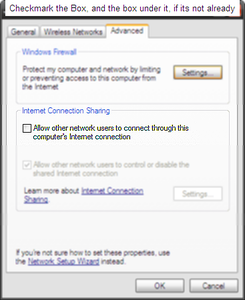

Step 2: Change Your Internet Properties
We have to change the internet properties so that your computer will share wireless internet with the Ethernet adapter. See pictures. They are in order as they should. They also have notes. After doing what all the pictures say, hit ok.
