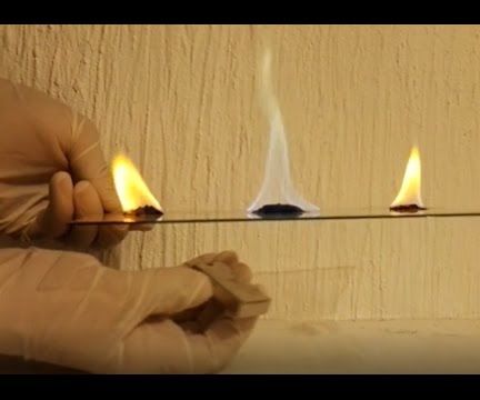

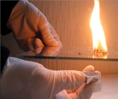

Step 3: ​Usage:
Put a small chunk of the ferromagnetic wax on a glass plate.
When touched by flame the material will not ignite unless exposed to a magnetic field.
To enable ignition put a magnet directly below the wax.
To increase flame size put the magnet directly below the fire.
To reduce the flame size put magnet below the fire and move it sideways along the plate.
To extinguish the fire put the magnet directly below the fire an move sideways swiftly.
