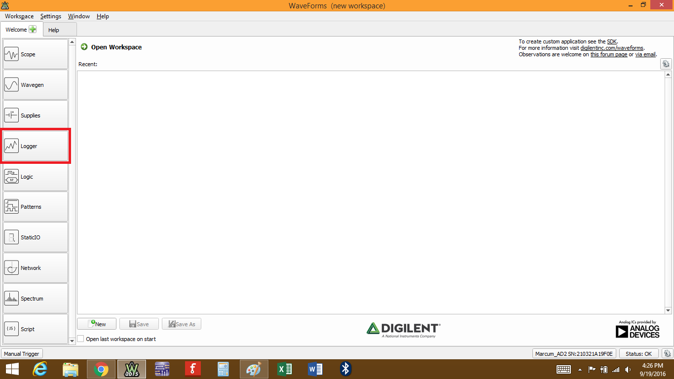

Once you have your AD2 and Waveforms 2015 all set up, open the Data Logger by clicking on the "Logger" button.
This will open the Data Logger window.

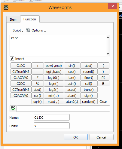

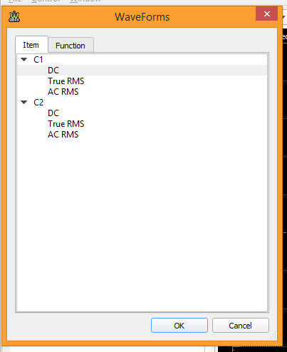

With a channel highlighted, click to edit the channel, which gives you two option tabs. You can change the channel to observe a different data parameter by clicking the "Item" tab.
Clicking on the "Function" tab allows you to set your own math channel using some basic math functions and one of the 6 predefined channels as a starting point.
