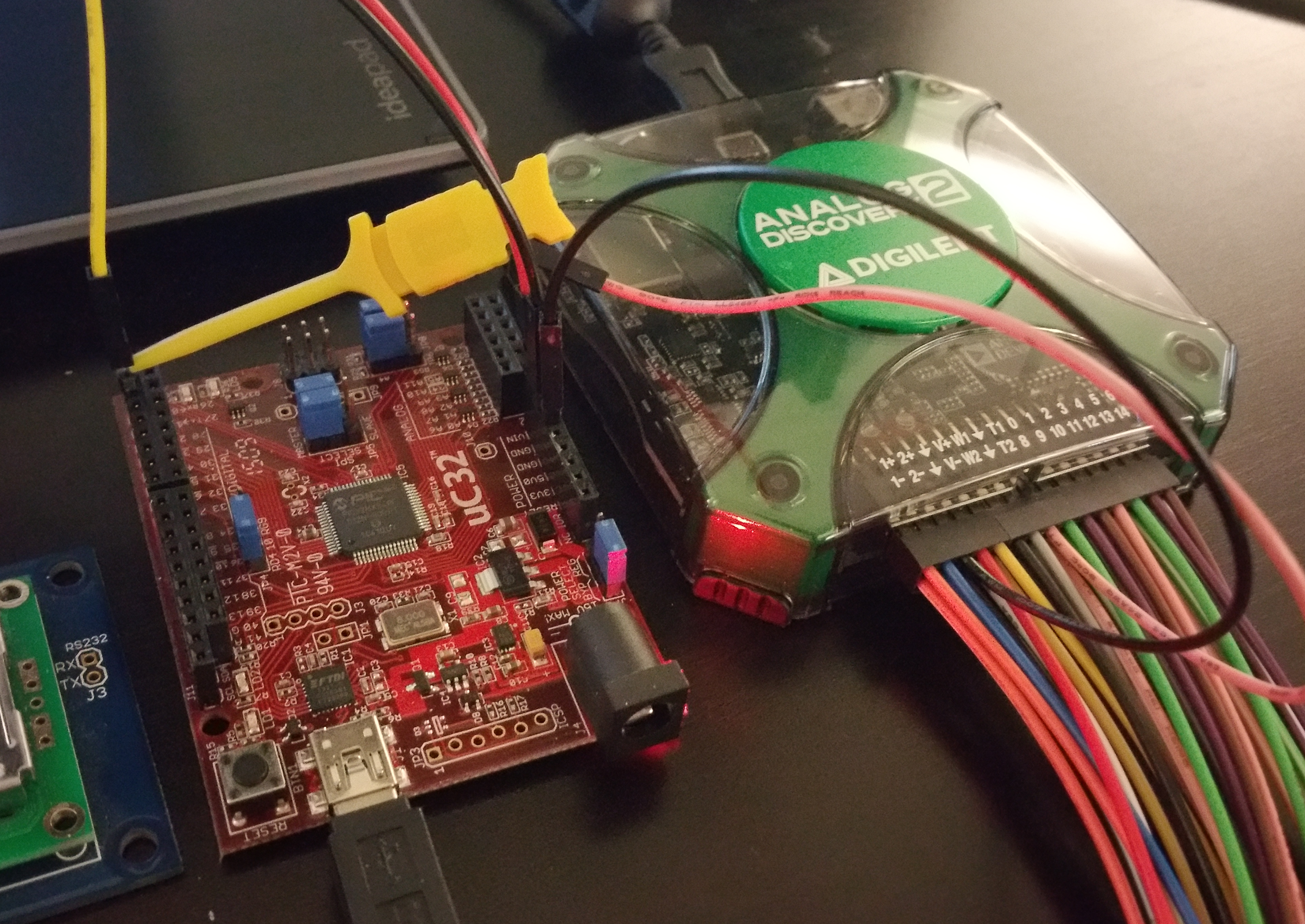

For this Instructable you will need:
-chipKIT microcontroller
-Arduino IDE with Digilent core installed
- Pmod with serial communication. This could be SPI, UART, or I2C. I will be using the Pmod CLS, a 2X16 LCD display.
- USB cable
-Analog Discovery 2*
-Waveforms 2015 software
- a computer with USB port to run the software
*You may also use the original Analog Discovery or the Electronics Explorer Board with Waveforms 2015. There are some slight differences in functionality between the AD1, AD2, and EEBoard, but nothing that will prevent you from following along if you have one of the other tools.

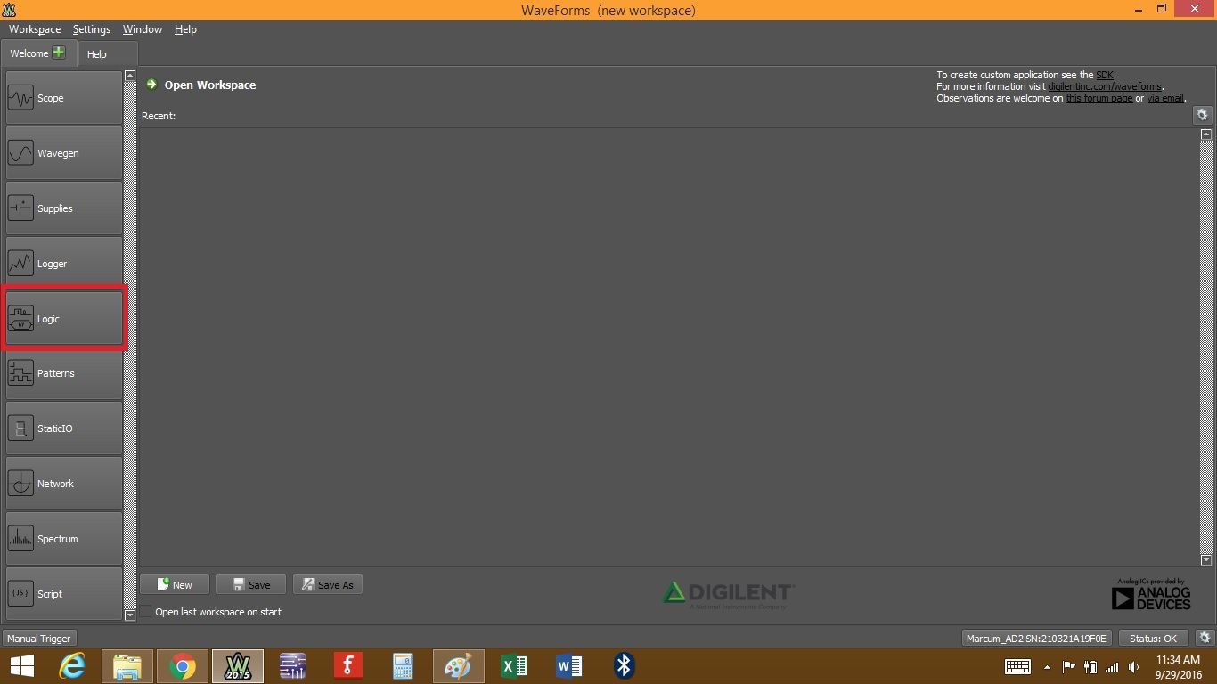

If you want some help getting your AD2 set up and calibrated, or installing Waveforms 2015, check out this quick start I'ble collection.
Once you have your AD2 and Waveforms 2015 all set up, open the Logic Analyzer by clicking on the "Logic" button.
This will open the Logic Analyzer window.

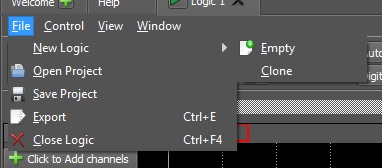

Along the top you'll see the "File", "Control", "View", and "Window" options.
Under "File" you'll see several options.
You can add a new instance of the logic analyzer, either by cloning the current analyzer settings or opening an empty instance with default settings. You can also "Save" the current logic analyzer settings, or "Open" a previously saved project. "Export" lets you save the current logic analyzer plot data, either as an image of the window in most common formats, e.g. *.bmp, *.jpg, *.tif, etc., or as a data file with the plot window information in either *.csv, *.txt, or *.tdms formats. "Close Logic" will close the logic analyzer window. This will not clear the current settings as long as you don't close Waveforms 2015 completely. Just click on the "Logic" button again and the window will pop back open with all of the same settings.

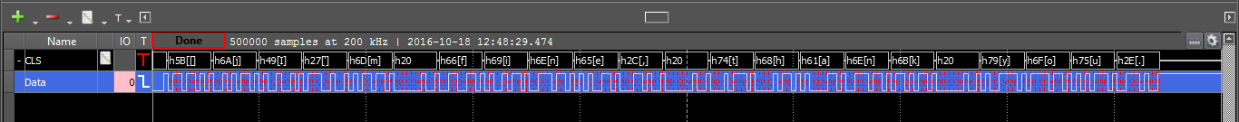

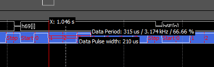

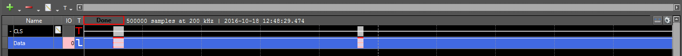

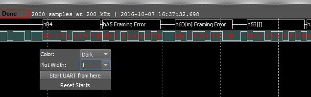

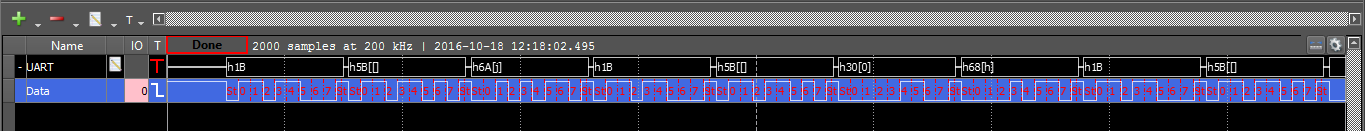

Original UART data captured. Notice how the data 8-bit data packets are clearly interpreted and displayed above as both hexadecimal (h1B, h5B, h6A, h1B, h5B) and ASCII characters ("ESC", "[", "j", "ESC", "[").
Now telling the tool to adjust where to start reading the UART data, beginning where it "sees" a UART Start bit. Notice how the data displays incorrectly, missing one packet entirely and complaining of framing errors and skipping some bits. But by the fifth packet (second "[") the tool had zeroed in on the correct UART sequence of bits and was able to decipher the remaining data correctly.

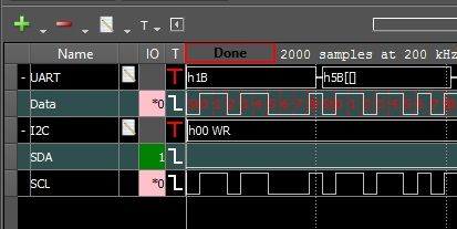

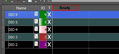

Now let's add protocols to the grid. By clicking you can add several different protocols to the grid.
Be aware that you can assign DIO channels to multiple protocols, i.e. you can use DIO 0 to watch your UART data signal as well as your I2C SCL signal. Notice the * in the colored box in the IO column to indicate that the DIO is doubled up.
Whatever data is captured will be displayed wherever that particular DIO is assigned. Luckily you have 16 DIO pins (32 with the EEBoard), so you should have no problem spacing out your protocols across the pins. Try and avoid doubling up if you can help it.

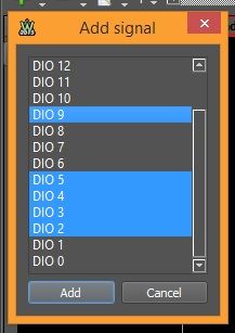

The first protocol in the list is Signal. Note that selecting any protocol will first open a small property editor window.
Select one or multiple signals using the "Shift" and/or "Ctrl" keys on your keyboard. Once you have your channels selected, click to add the selected signals to the grid.
You can edit each channel by double clicking it on the grid, or clicking either edit button, in the grid next to the signal name or above the grid . For Signal, the only thing you can edit is the name of the channel. You can change the trigger condition from the grid by clicking on the symbol in the "T" column. "X" is set by default, but the same options described above apply here as well.

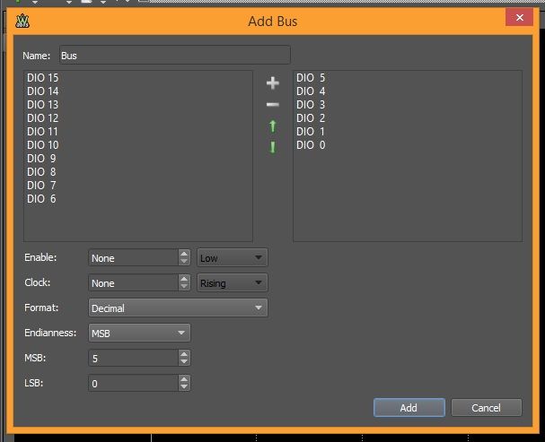

Bus
The next protocol option is "Bus".
Select the channels you want to use for your bus in the left table. Click to add them to the table on the right. Remove any channel from the right hand side by selecting it and clicking . Clicking or with a channel selected allows you to change the order of the channels in the bus.
selects an optional enable pin and polarity.
selects the optional clock pin and sampling edge.
allows you to choose the numerical format for how the interpreted data is displayed. There are a number of formats to choose from.
sets how the data is interpreted, either MSB first or LSB first.
and set the values for the first and last indices. The minimum for LSB is -32 and the maximum for MSB is +31. Changing either will change both, maintaining a separation difference equal to the number of channels assigned to the bus. This tool works like bit shifting the interpreted data, adjusting up/down the max/min values interpreted by the bus by a factor of 2 with each increase/decrease of the indices.
You can set the trigger for the bus by setting the trigger value for each channel in the "T" column.
The tool will only trigger when all conditions for each channel have been met.
To enable the protocol trigger wizard, click on the blank box at the top of the "T" column, next to the protocol name.
will appear in the "T" column. Click on it to open the trigger wizard.
With this wizard you can set the trigger condition to look for a specific set of bits, corresponding to the decimal value entered in the box.

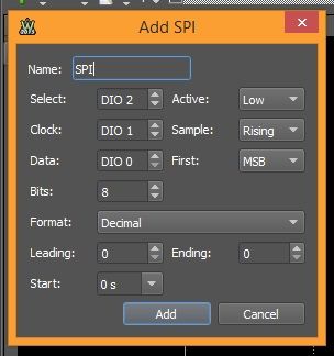

SPI
Next on the list of protocols is Serial Peripheral Interface, or SPI, which is used extensively in embedded applications for synchronous serial communication.
Set the for your SPI.
Assign a DIO to to watch the slave select signal and set the status as high or low.
Set a second DIO to watch the clock signal and set it to on either the clock rising or falling edge.
Set a third DIO to watch the signal (either MISO or MOSI) and set whether the bit in the data packet is the MSB or LSB.
lets you set the bit size of your data packet (1-32 bits).
lets you set how many leading bits should be skipped when calculating the data value. Similarly, sets how many trailing bits should be skipped when calculating the data value.
Using you can delay the start of acquisition with respect to the first sample.
Once you have your SPI defined, click to add it to the grid. Once there, you can edit the SPI properties by double-clicking any of the SPI channels, or by clicking either or .
You can set it to on SPI start, SPI Stop, or when a specific Value appears in the data packet. If you choose Value, define what value to look for in the box.

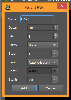

UART
Next is Universal Asynchronous Receiver/Transmitter, or UART. If you are familiar with microcontrollers in either the chipKIT or Arduino families, the Serial library uses UART to transmit/receive data.
Name the UART protocol whatever you want in the box.
Set the AD2 DIO pin with to monitor the data being sent or received. You can only monitor either the TX or RX line with one instance of UART with the Logic Analyzer. If you need or want to monitor both TX and RX at the same time, simply add another instance of UART to the grid, assigning the second data line to the second instance.
allows you to select between standard and inverted signal polarity.
Define how many bits are in your data packet with . You have a range of 1-32 bits for the data packet size.
is defined as Odd, Even, Mark, or Space depending on the settings of the signal under observation. Select None if no parity bit is used.
lets you define how many stop bits are present in the signal.
The default baud rate is set at 9600, but set to "Manual" to manually set the to a different setting.
Set a delay in data interpretation using . The interpreter will not begin until that much time has passed with respect to the first sample.
Once you have your UART defined, click to add it to the grid.
To edit the UART protocol, double click the Data channel in the grid or click on either in the grid or above the grid. Make the appropriate edits, then click to return to the grid.
You can set the tool to trigger on Break, Idle, or a Value. If Value is chosen, enter the value of the data packet in the box. Click to return to the grid.

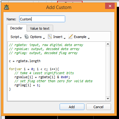

Custom
While not technically a protocol, the last option in the list is Custom, which lets you define your own protocol interpreter.
Waveforms is coded using JavaScript. Utilizing the SDK that downloads with Waveforms, custom applications can be built and included with your own installed version of the Waveforms application. For more on that, see the SDK PDF that downloads with Waveforms 2015 and the Waveforms reference manual.

The Pmod CLS is a great device to use for this example because you can communicate with it using SPI, UART, or I2C. For this example I'll use UART, and from the reference manual I know that with CLS Revision E (, found on the underside of the PCB), I need to set the communication selection jumpers like so:

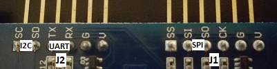

There are two 6-pin Pmod headers on the CLS, J1 and J2. The silkscreen on the bottom shows the different communication protocol connections.
Since I'm using UART, I will need to use the RX pin on J2. I won't be expecting to receive data from the CLS, so the TX pin doesn't need to be connected. Also on J2 are the SCL and SDA pins for I2C communication. Use J1 for SPI communication. Both J1 and J2 have 2 power (V and G) pins for powering the Pmod CLS

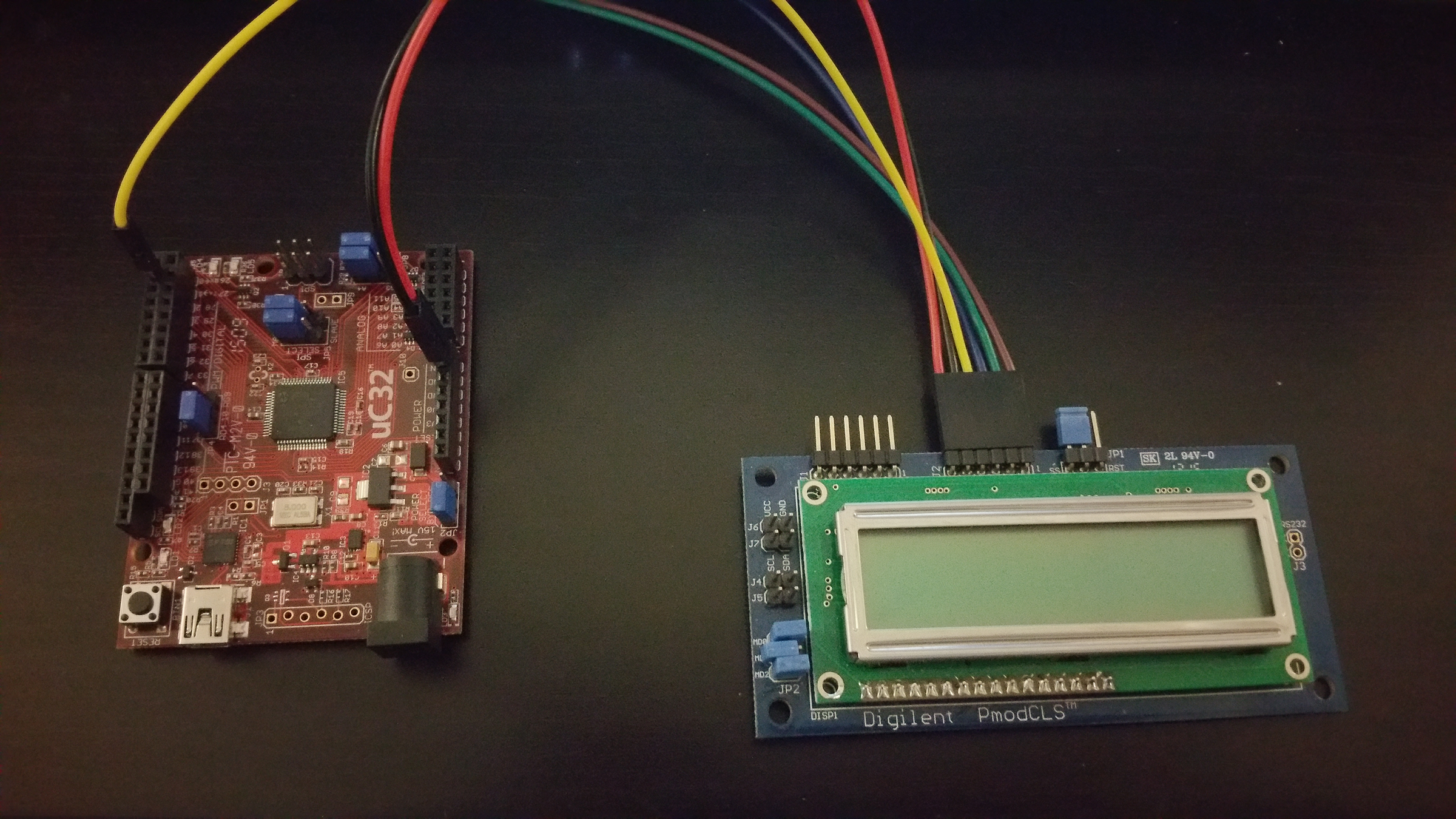

Using a 6-pin MTE cable, connect the CLS to the ChipKIT board. The image shows a uC32.
Be sure to connect the RX pin on the CLS to the TX pin (1) on the uC32.

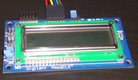

Download the code to the uC32 and the messages should display on the LCD.
Utilizing a mini grabber test clip, you can piggyback on the uC32 TX signal to analyze it with the Logic Analyzer. Be sure to also connect one of the AD2 GND wires to a GND pin on the uC32.
Set up a UART protocol interpreter with the Logic Analyzer tool. The default property settings will work fine here.
Click on the "X" in the trigger column and select "Fall."
The UART data line holds logic high when not in use. The start bit of the data frame is indicated by dropping the line to logic low, so we know that we are about to get a data packet when the line goes low and the tool will trigger on that first falling edge.
In the box, select Normal so that the tool will wait for the trigger and not automatically begin acquiring data.
At the top right of the plot window, enter 4.5 ms in the box. This will center the plot at 4.5 ms, shifting 0 ms to the left to allow us to see more data.
Click and the tool will wait for the trigger condition to be met, indicated by the status indicator . Reset the microcontroller to begin sending serial data on the TX line. The tool will trigger and acquire 9.5 ms of data.
We can see that the analyzer correctly interpreted the data packets and the hex value along with the ASCII character is displayed along the top.
The only problem is that we know that we sent a lot more bytes of data than the 9 we can see in the plot. Using the record function, we can capture the entire data stream. Let's look at that.
Select Record from the box. The plot will likely resize, but don't worry the data is all still there. Save it, export it, whatever, but we'll get another sample in a minute.
Click to configure the record function. A configuration window will open.
Our serial baud rate is set at 9600, which is essentially 9.6 kHz. We want the sample rate to be significantly higher than that in order to capture the data. The default should be 200 kHz, but any value higher than 10X baud is fine, just don't go to high or you won't have enough samples in the buffer to record enough data for the time required.
Set the number of to determine how long the tool will record. Multiply your rate by the time required for acquisition to get you samples. In this case I already know that the uC32 is finished transmitting data to the CLS after about 2.5 seconds, so with a rate of 200 kHz, that leaves me with 500,000 samples.
is set by the tool in this case, so don't worry about it.
Use the box to set the position on the plot of the first sample. 0% is far left, 100% is far right, and 50% is right in the middle. For this example, set it to 5%.
Once everything is set, click to begin acquisition. The tool will buffer a few samples and then wait in status. Reset the uC32 to begin transmitting to the CLS. The plot should look like this once it finishes.
It doesn't look like much, but luckily we recorded it, so we can zoom in to see the data stream.
Use the scroll bar above the plot window to move left or right through the recorded data plot.
Notice that the data packets have been interpreted by the tool and both the hexadecimal and ASCII values are displayed at the top of the plot window.
Click one of the hot track buttons at the top right of the plot window. Zoom in on the recorded data stream and hover the mouse over it. Measurements and associated labels will appear on the plot, showing information like the data pulse width, period, etc.
