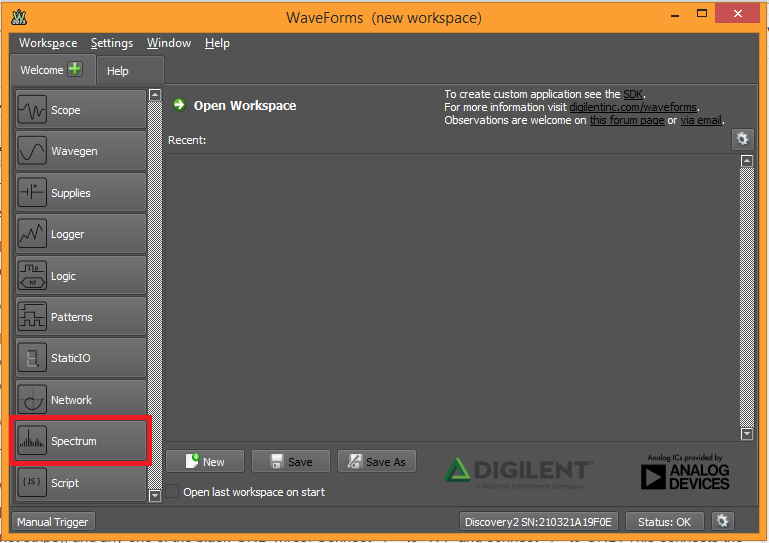

Plug in the AD2 and open Waveforms. Open the spectrum analyzer by clicking on the "Spectrum" tab on the left side of the window, toward the bottom.

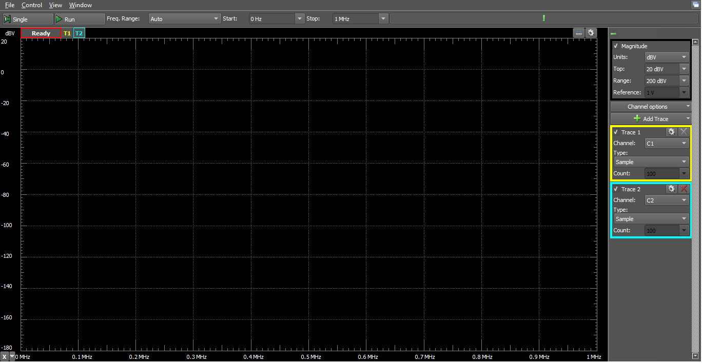

The spectrum analyzer window will pop open.

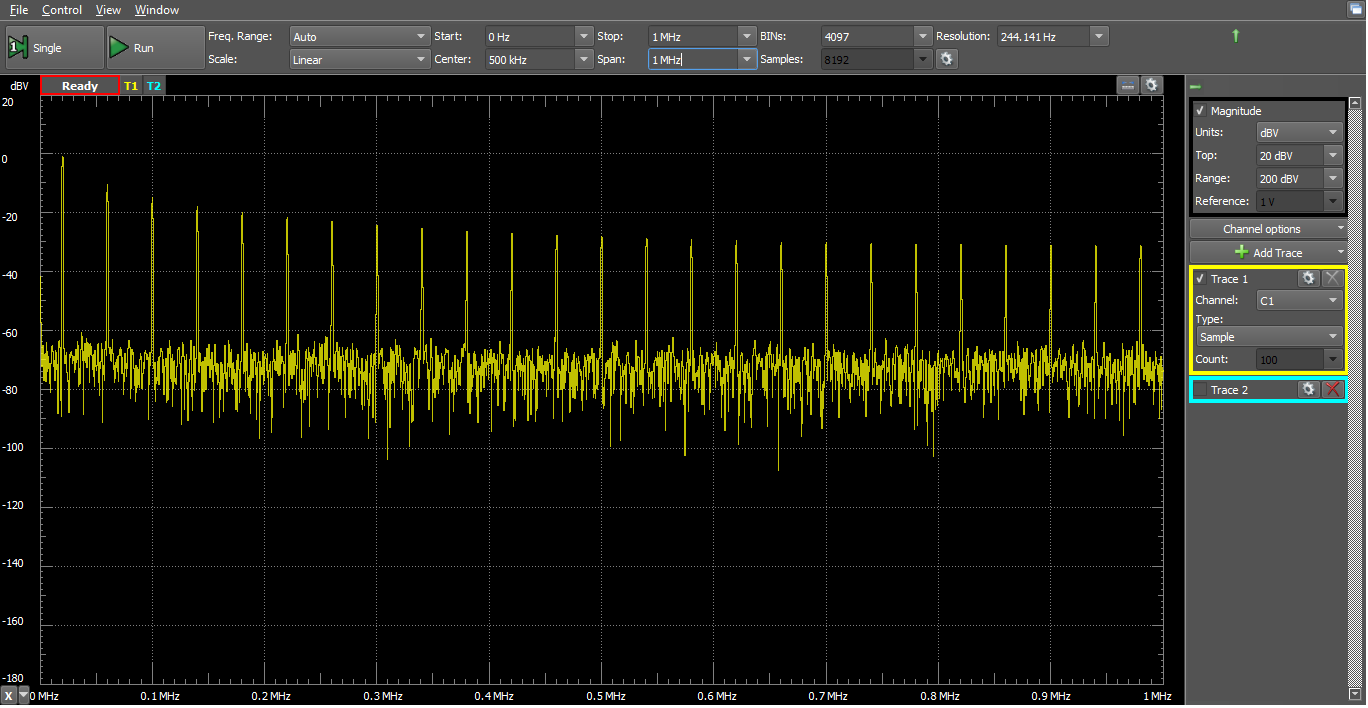

With the wires connected, turn on the waveform generator by clicking "Run" at the top of the window. Go to the analyzer window and click "Run" as well. Without changing any default settings, you should see something like this:
The image is constantly jumping around because the analyzer is constantly getting random amplitude readings at all of the frequencies between your lower and upper frequency limits. Also, the frequency we chose by default is difficult to see in this image. So let's make some adjustments so we can see it better.
The first thing I like to do is remove data that is not useful. On the right side of the window, you will see two boxes that correspond to the two analyzer channels. Since we are only using channel 1 at this point, click on the little check mark in the top left corner of the channel 2 box. This will remove the channel 2 readout from the window and we are left with only channel 1.
Next, at the top of the analyzer window you will see a small green arrow at the right hand side of the screen. Click this arrow and you will have some various options.

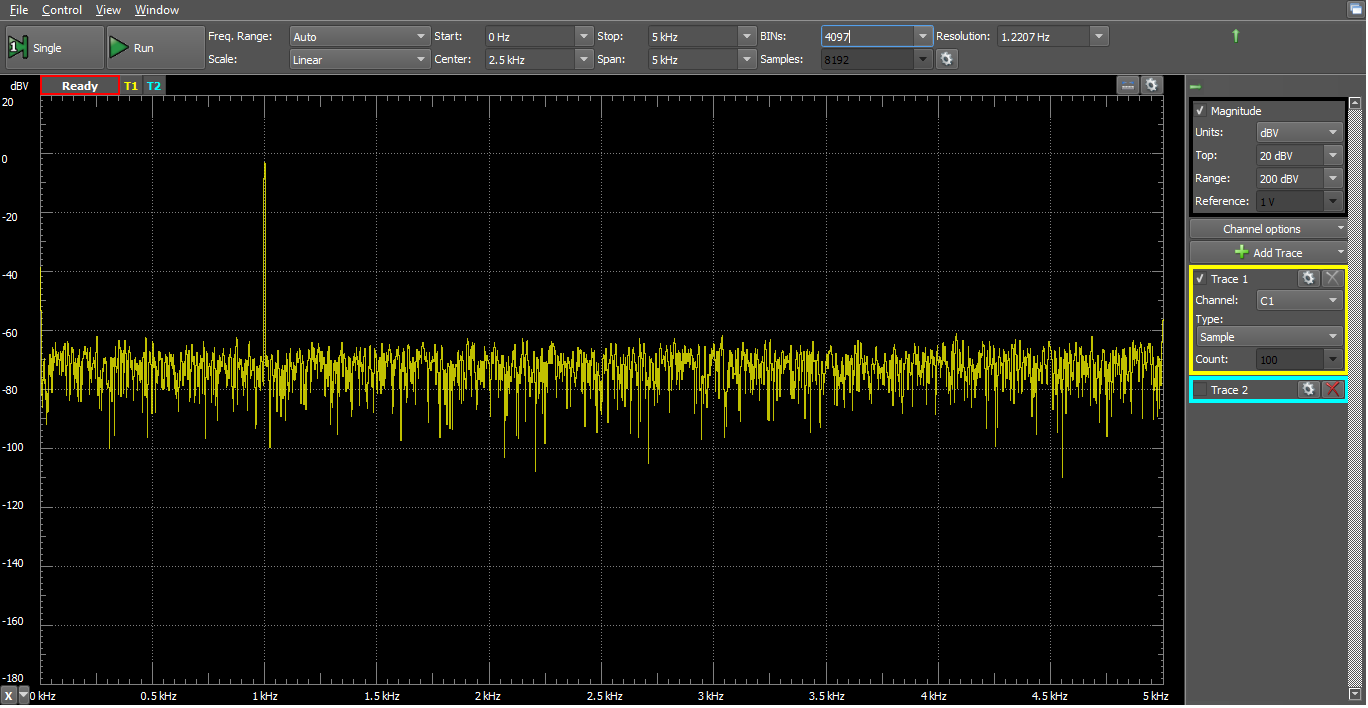

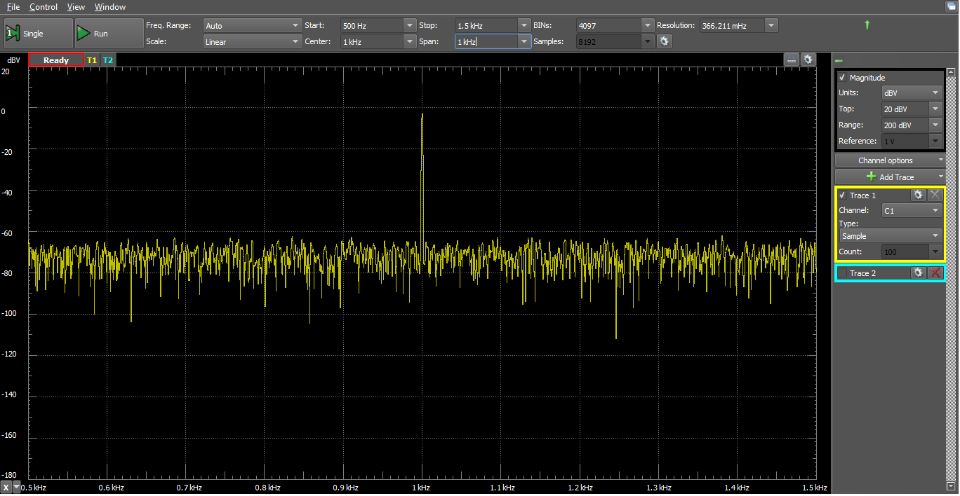

You can set the lower and upper window limits manually by entering in values into the "Start" and "Stop" boxes. You can also use the "Center" and "Span" boxes. We already know that we have a 1 kHz signal, so let's leave 0 Hz in the start box and put in 5 kHz in the stop box. You should see something like this:
You can also adjust the window size by deciding on what frequency you want the window image to be centered on, and then giving the window a span, or width. The span is divided in two, and then that resulting value is added or subtracted from your center frequency to give you your window max/min values respectively. Since we are looking at a 1 kHz signal, put 1 kHz in the center box and make your span 1 kHz. This will make the window center on 1 kHz and the x-axis scale will go from 500 Hz to 1.5 kHz.
You will also notice that the image doesn't appear to "run" as fast now. Go back up to the top of the window and click on the BINs drop-down arrow. By choosing a smaller value, you change the number of frequency BINs you are using. (Basically it divides up the window into that many slices and takes a sample at each one. It then just draws a straight line between each data point.) This will automatically adjust the sample rate as well as your resolution. The image will now run faster, but you don't have as much data to work with. Make adjustments as you see fit.
Ok, so now we have a pretty good view of what is going on. We can see that we have a solid spike at 1 kHz, and a ton of smaller spikes in the rest of the window. When we look at the magnitude axis (vertical) we see that it is set on decibels (dB). This is a very common way to measure signal strength. Most of the noise is centered right around -70dB, which is an extremely low value. This indicates that the noise is exactly that, just background noise in the system, but it is so low that it shouldn't have any effect on the system. It comes from transient signals generated by whatever interfering signals are around you, as mentioned previously. If we were in the radio frequency range with an antenna attached, you could pick up the background radio noise of space.

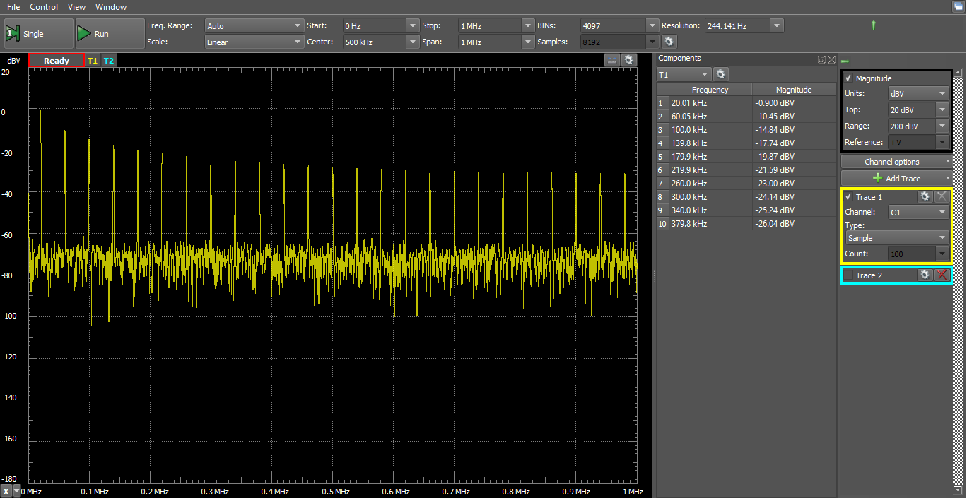

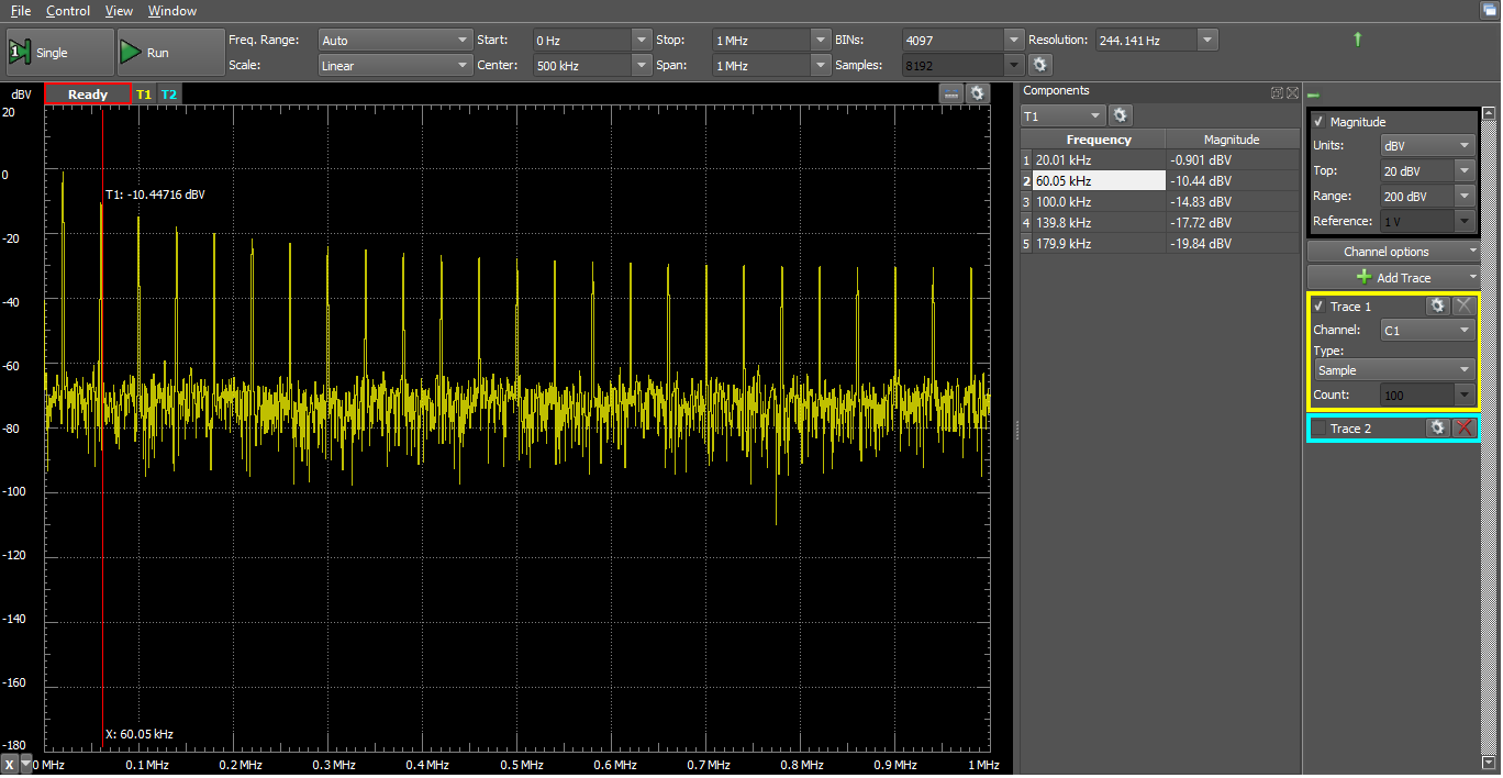

Now let's expand our view and see what's really going on. Set your center to 500 kHz and your span to 1 MHz. You should see something like this:
Now let's see what frequencies are the strongest. You should be able to tell from the image, but if you play with your window start and stop values or the span value, you will see signal peaks at various places that won't be apparent with a different resolution. To see exactly which frequencies are strongest, click on "view" at the top of the window and then choose "components". A small side window will pop up showing all of the strongest frequencies that can be seen in the current window. By adjusting the window max/min values, these readings will change. Which frequency is the strongest? Does that make sense?
You can change the number of components displayed by clicking on the small gear in the component window and changing the value in the option box. If you click on the "stop" button at the top while the component window is open, you can click on any of the frequency values and a vertical red line will appear in the window at that frequency.

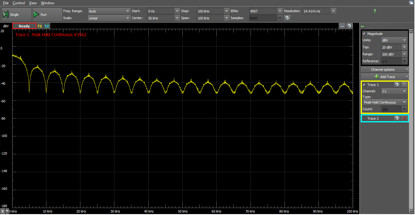

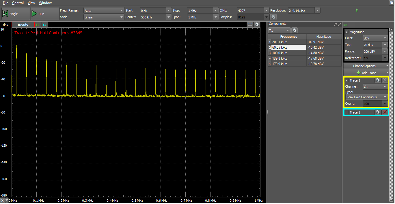

Click on "run" again and let the analyzer do its thing. If you look all the way to the right side of the screen, you will see the little box that gives you trace options. Click on the drop down menu beneath "type" and you will see several options. My favorite is "peak hold continuous" so click on that and see what happens in the window. This can be helpful to remove the noise and capture small peaks that are not noise but still rather weak and can be lost in the noise.
