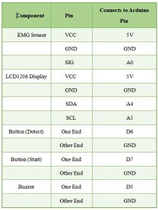

The hardware setup is the foundation of the entire project, ensuring correct connections between components is a prerequisite for functionality. Before starting the actual connections, I first drew a wiring diagram to ensure that the pin connections of each component are clear (below is the wiring diagram for the main components). Following the above wiring diagram, I completed the basic hardware connections, ensuring that each component can be powered and communicate properly.

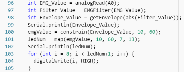

After completing the hardware connections, we need to write the corresponding software code to achieve various functions. Software development includes modules for signal acquisition, processing, feedback display, and data recording.
  1. Development Board: Arduino Uno
  2. Programming Language: C++
  3. Development Environment: Arduino IDE
  4. Version: Arduino IDE 1.8.13
Our code mainly includes the following modules:
  1. Initialization Module: Initializes various components, including the EMG sensor, LCD display, and buttons.
  2. Signal Acquisition Module: Reads EMG signals from the EMG sensor and performs preliminary processing.
  3. Standard Value Recording Module: Records the current EMG signal as the standard value when the user presses the detection button.
  4. Real-time Monitoring Module: Monitors the EMG signal in real-time and compares it with the standard value after the user presses the start button.
  5. Feedback Display Module: Provides feedback information through the LCD display based on real-time monitoring results.
  6. Data Recording Module: Records the user's training data each time, including the number of actions and EMG signal strength.

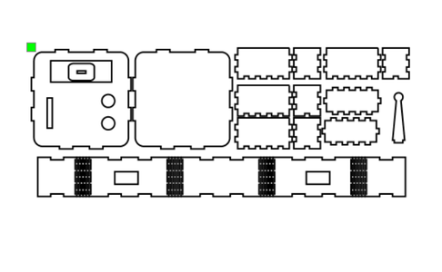

Building on the initial design, I have made the appearance so that it looks more like a little robot, with a wooden antenna on its head. I laser cut all the pieces as before, and the laser cutting pattern is attached. The two parts on the sides function as space for holding the wires for the EMG sensors as well as the arduino to computer wire for transmitting the code. This takes advantage of the fact that there is a little excess space in the back of the circuitry, allowing a more compact design. The back is once again made of acrylic because I find it more aesthetic than covering up the circuitry completely.

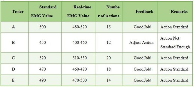

Step 4: Testing
Verify whether the fitness assistant based on EMG (electromyography) sensors can accurately collect EMG signals and process and provide feedback through the Arduino controller. Verify the accuracy and stability of the device under different conditions to ensure its scientific validity.
Experimental Steps:
1. Attach the EMG sensor to the abdominal muscles of different testers.
2. Start the device, press the detection button, and record the standard EMG signals of each tester.
3. Have different testers perform crunches or sit-ups, press the start button, and monitor the EMG signals in real-time.
4. Record the changes in EMG signals and feedback information of different testers, and analyze the accuracy and stability of the device.
