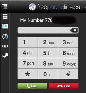

Once you have got a phone number you can download either a Windows or Mac version of the software.
Install the software, launch it and login with the same login/password you used to register on the website.
Congratulations you have a free working phone number - no credit card needed.
