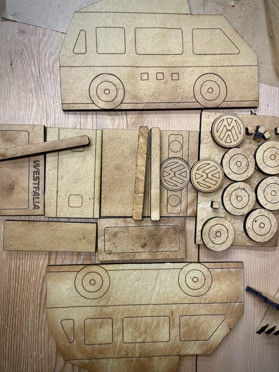

Step 2: Cut on the Laser
Once the sheets are ready, it is time to cut the shapes out on your laser.
Attached are the templates in several formats:
  • Lightburn
  • SVG
  • DX
For my Atomstack S20 Pro, cutting was slow: 2 passes at 3mm/s. However, the results were very nice with clean edges. A more powerful laser would do even better.
