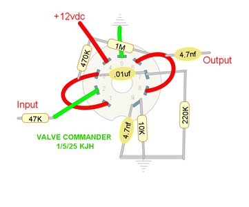

Step 1: Build Two Tube Circuits
The diagram above shows a closeup of one 12FQ8 tube section. The image is as if you are looking at the bottom of the tube socket. The 12FQ8 is a dual triode tube, so the signal path goes in one grid (Pin 2), and then out of the tube (Pin 1 & 3), through the .01 Capacitor and into the other grid (Pin 7), and then out of Pin 6 & 8. It's like two tubes in one. You will need to build two of these!
I suggest building the tube circuits individually like the above image and then connecting the two tube circuits together later on. It is completely up to you, but I find it is easier to keep track of where I am at when building one circuit at a time. Just like the Valvelitzer or Valvecaster, you can solder the resistors and caps directly to the tube socket to keep things clean. These small components can be tricky to position and solder, but I have confidence you can do it! I suggest using solid core wire because it is stiff and you can form it around the pedal box. 24ga solid core wire will work well.

Step 4: TWEAKS
There are many ways to make this your own pedal. See the diagram above for changes you can make. I would suggest using a breadboard to test the sound before soldering it all together.
You can:
  1. Change the 470K & 1M resistors load resistors. Increasing them will increase the distortion but it will also lower the output of your guitar signal. Eventually, the output will be quiet and very low volume.
  2. Change the 10K cathode resistor from 5k to about 20k ohm and the cathode capacitor from 4.7nf up to 10UF. Since you have two tubes you can do a variation between the two.
  3. You can change all coupling capacitors from 4.7nf (.oo47uf) to a .01uf. The bigger the capacitor, the more bass you will receive through the audio signal. Go too big and you'll end up with a muddy-sounding circuit.
  4. You could also bypass the second tube, and the first tube acts like a booster pedal, boosting the signal, but not distorting it much. The possibilities are endless! Have fun and rock on!
