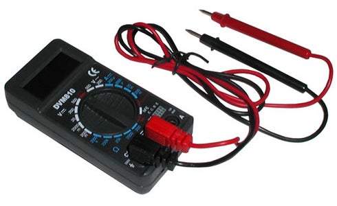

Step 3: Adding the Digital Readout
Adding the digital readout is really simple! Just open up your multimeter and solder your output to the test leads. Add a switch to the battery. And that's it! You're done :D

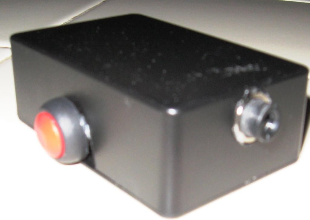

Step 4: You're Done
Test it and have fun! Put it in an awesome enclosure like I did to impress your friends :)

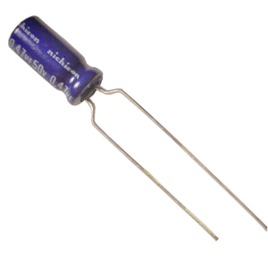

    Hi there,
    This is a very cool instructable! I already bought all the parts, except for the capacitors. I am quite a novice with electronics so please be patient… :)
    “0.1 uf Mylar Cap (~$0.10)” – Is this 0.1 uf Radial Electrolytic capacitor? In the pictures included in the pdf file it is a 0.47 uf 50v capacitor, will this also work?
    “1 Axial Electrolytic Cap (~$0.20)” – In one of the comments “silencekilla” said that is should be a radial capacitor, is this correct and what should the value be? 1 uf ?
    Thanks
    im sorry if i missed this but what voltage power supply is used?
    the links are broken so i cannot see :(
    and also would the resistors regulators and such change if i were to use a different voltage power supply?
    (sorry i do not know the purpose of these things and what they do)
