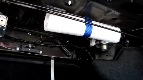

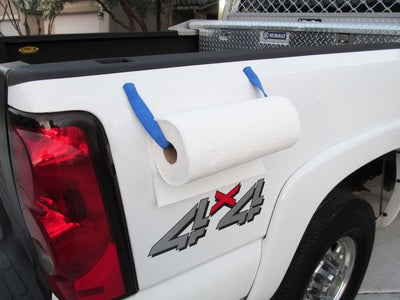

There are some things you don’t always need, but when you do, having them makes all the difference. Like an umbrella when you didn't expect rain. Or flip flops, because fancy shoes are only comfortable for so long. To keep it all available and out of the way, I made these gear straps. They are made from 12 inches of durable nylon webbing fitted with 2 neodymium magnet assemblies.
The magnets are adjustable so you can fit the straps around different items like sun screen, paper towels, or, rope. When you're working on a car you can wrap a flash light and stick it under your hood. Or you could even stick it on the side of you car when you're changing a tire at night.

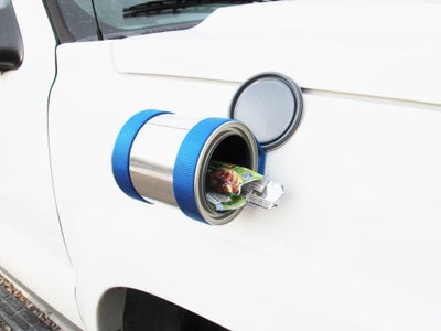

Need a better way to serve lunch in the back seat? Make a Backseat Caddy.

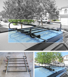

Or you could add a roof rack on a budget. DIY Roof Rack Cross Bars.

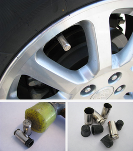

Maybe some valve stem caps Rambo would be proud of? Bullet Shell Valve Stem Caps.

First of all you'll need neodymium magnets. You can find all kinds of sizes by doing a web search. Amazon has a bunch. I'm using 1/2"X1/4" magnets.
If you're using multiple magnets you'll need backing discs. This will keep the magnets from flipping onto eachother. The ones I'm using are laser cut from 22 gage sheet metal. Of course you could always use metal shears instead of sending the file off to a laser cutter.
Lastly you need tubular nylon webbing. I'm using 1" width. You can typically find it at sporting good stores.
Each section of webbing will have 2 magnet assemblies.
Step 3: Make the Magnet Assemblies.
It's a good idea to use glue that has a setup time here. Super glue bonds in seconds so you have to work fast to line up the disc with the magnets. Wear gloves to avoid touching the glue.
Place a small drop for each magnet onto the backing disc. Stick the magnets on and line them up. Wipe off any residue.
When you're done you should have at least two assemblies, one for each side of the strap.
Step 4: Make a Fusing Tool.
Cut out a strip of 22 gauge sheet metal. Use a socket and pliers to form a curve. Finally, trim it so it's just longer than the width of the webbing.
Step 5: Seal the Magnets In.
Since this is tubular webbing it has an open space within it. Place one magnet assembly into each end of the webbing. Push them far enough in so they don't interfere with the sealing process.
Hold the metal strip within locking pliers. Heat the strip with a flame so it's hot enough to melt nylon. Set the strap on a piece of wood and press the hot strap through the webbing. This will cut and fuse the webbing at the same time. Do this to each side. Now the magnet assemblies are sealed in.
