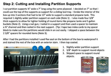

Step 2: Cutting and Installing Partition Supports
Please see pic.

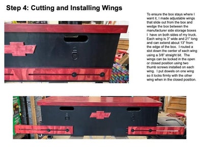

Step 4: Cutting and Installing Wings
Please see pic.

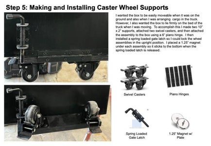

Step 5: Making and Installing Caster Wheel Supports
Please see pic.

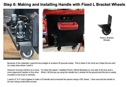

Step 6: Making and Installing Handle With Fixed L Bracket Wheels
Please see pic.

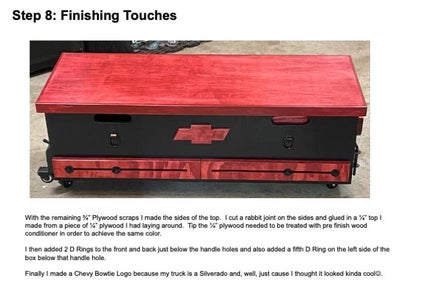

Step 8: Finishing Touches
Please see pic.

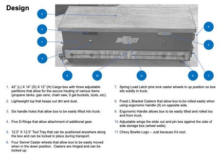

Step 10: My Design
Please see pic.
