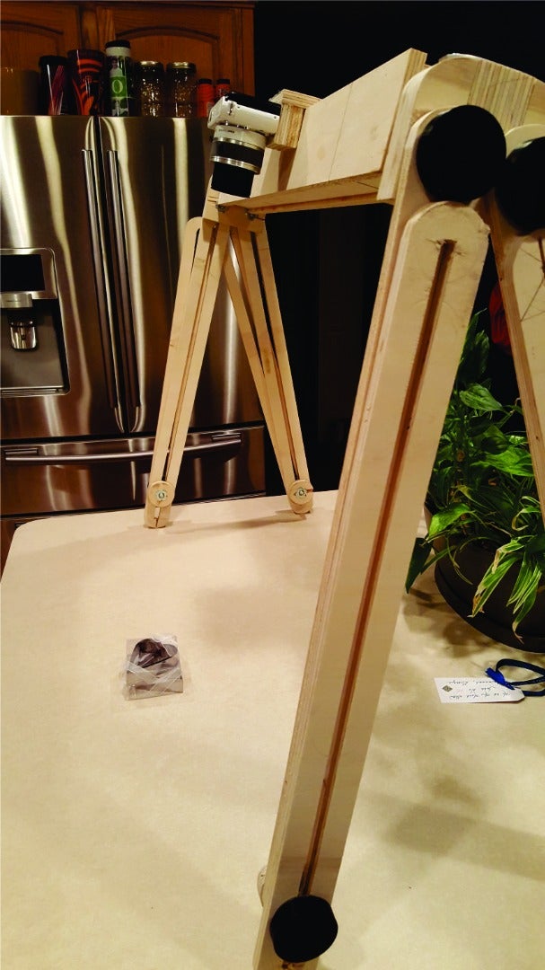

While trying to take videos, we found it very hard to take good pictures from unique angles. We decided to design and build our own overhead camera rig that we could configure to multiple heights and configurations. When we saw the plywood instructables contest, we thought why not make it from plywood and enter the contest. The entire project was made from a single 2 x 4 foot 1/2 inch sheet of plywood with a total cost under $25!

8 - 2 x 24 inch pieces of plywood make up the legs. Make a 23 inch by 3/8 inch center cut and round the ends.

Step 3: The Leg Hub
Step 1 - rough cut 4 pieces of plywood to 3 1/2 x 4 inches (cut slightly larger to allow for trimming later).
Step 2 - glue two pieces together and clamp and trim to 3 1/2 x 4 inches.
Step 3 - use leg hub dimensions to finish block.
Step 4 - use scrap aluminum/metal to make a bracket to hold main rail inside to the hub (see pictures).

Step 6: Final Assembly
Once you have all pieces put together, all you need to do is connect the legs to the leg-hub and then connect the outer legs to those legs.
Step 7: Camera "Car"
The camera car should be designed to a specific camera. The most critical part is the 1/2 inch gap between the camera mounting plate and the "hook" plate. See pictures for references.
