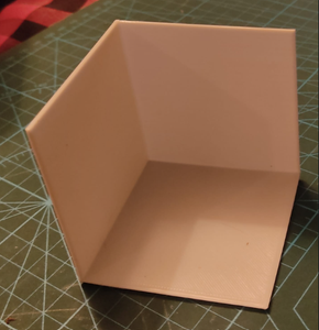

Step 1: Holder Pieces
Cube holder:
  • Generate 2 cubes. 1 red and 1 trans X:70mm, Y:70mm, Z:70mm
  • Center the cubes, take the transparent cube and move 2 mm in X and Y
  • Group and make a copy.
Step 2: Holder Base
Generate 2 rectangles
  • Red rectangle: X:33mm Y:76mm Z:20mm
  • Trans rectangle: X:31mm Y:74mm Z:20
  • We choose "holder pieces" piece (Copy). Move to 45º degrees and prepare it to cut.
  • Align the red rectangle with the "holder pieces" piece and move in Z 2mm (Better if we give 4mm)
  • Group to make the cut and that´s it.
