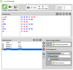

Step 4: Connect Lilypad With Processing
Before moving forward to wireless part, it is necessary to connect Arduino with Processing. The processing code is provided towards the end of this section. Follow the steps below to make Arduino communicate with Processing.
[Testing]
Start with initial testing by sending numbers from Arduino to Processing.

2. Open the serial monitor and check if the numbers are appearing on the serial port monitor. Make sure you close the serial monitor. It is very important to close the serial monitor post the number check to ensure that errors don't pop up.
3. [Processing] Receive this number form Processing and display on the console.

TIP: If XBee doesn’t work, try using the following instructions to troubleshoot. (For Mac User)
a. Install driver
FTDI drive: http://www.ftdichip.com/Drivers/VCP.htm
b. connect XBee to USB
c. Open [XCTU]
d. Click [discover radio devices]
e. Add [Select Devices]
f. click (+) and write +++ [send selected packet] ==> You’ll receive OK.
d.Initialize to factory mode. Same process as [ step f ]. (you must add )
ATRE
ATWR
ATCN
(follow with the image)
